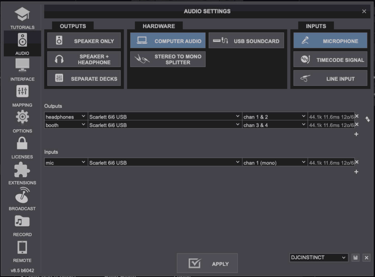

Okay, so this is encouraging that it's not an issue with Scarlett I/O boxes.
- Phantom is on, yes. I've tried it with two phantom mics and a dynamic... all the same.
- Audio setup... Scarlett out 1&2 -> booth / Scarlet out 3&4 -> cans / Scarlett in 1 (mono) <- Mic / Master Out to broadcast & recording only (this same config works perfectly in Mixxx.). I have also tried not using the 'booth' output and setting 3&4 to master, but this makes no difference. Input 1 gain on Scarlett is cranked as far up as I can go without clipping. Scarlett MixControl adds a +6dB boost to input 1. VDJ is correctly detecting the Scarlet to be at 44.1k sample rate.
- No... it feels about 25% down on where it should be.

          An image of your audio setup screen would be easier to see if there is anything obvious there.
I don’t have the focus control adding anything to the mic. It’s just set to a standard line input.
Let’s see your audio config and we can trouble shoot from there.

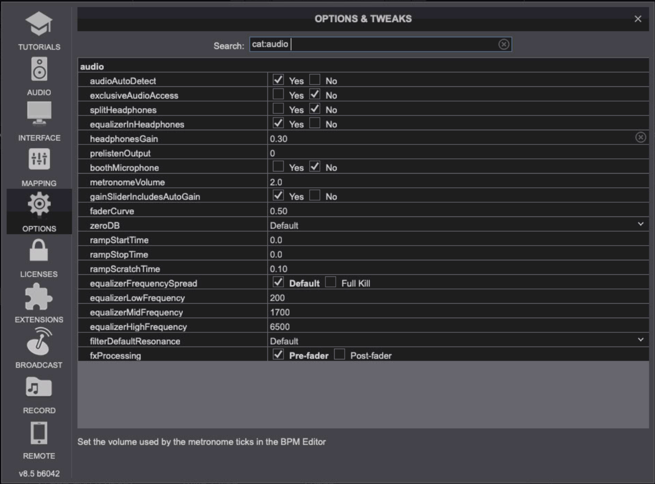

I think this is what you want...?
I can't uninstall the Focusrite MixControl thing as my 6i6 won't work without it, but all it's doing is adding a little gain to the inputs.

          Why do you have headphones & booth.
Usually it would be Master 1&2 and Headphones 3&4.
But at the very list you should have a master out. Change the booth to Master.

As I said in the first post [edit: second post], I tried switching booth to master. Made no difference. As to why I'm doing it... because I'm broadcasting over Icecast with no local speakers. I don't want the microphone output in my studio or I'll get feedback (and the slight delay will drive me nuts), but I do want the mic broadcast and recorded. This has been a perfectly working setup since March whilst I was using Mixxx (which as you know is free and open-source), but the mic volume is too low in VDJ.
In Mixxx I have the input gain on the Scarlett at about 50% (well below clipping) and the input gain in Mixx to about 75%... and it's loud (bouncing 0dB on the VU). In VDJ I have the gain on the Scarlett set to 75% (any more and it clips) and the gain in VDJ to 100%... and it barely reaches 40% on the VU meter. But more importantly, my listeners can barely hear me speak whilst the music is about the same level as it was when I was using Mixxx.
Is VDJ doing something weird with CoreAudio?
Posted Thu 30 Jul 20 @ 8:15 pm
          Okay, so I've been fiddling around with the settings and by pulling the ZeroDB option down to -3dB or -6dB it balances things out a bit. I'll let you know after tomorrow's broadcast if anyone thinks the music is too quiet and if people can hear me.
Still not sure why there is this huge difference between VDJ and everything else in mic channel sensitivity, but hopefully this is a working solution.
