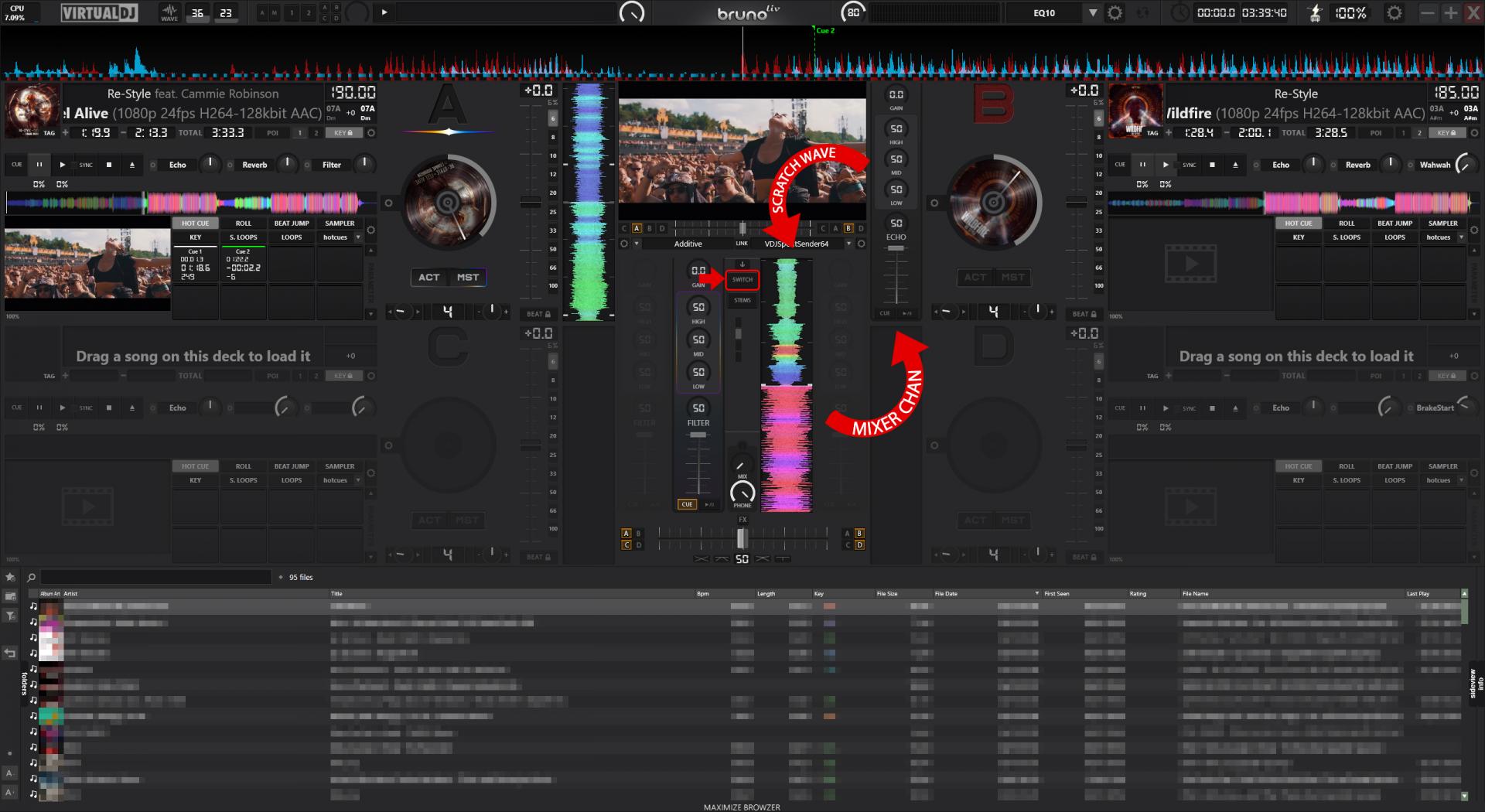

So, I made it =)
think it looks nice and have a great functionality when mixing with controllers.
Thank you all so much for the advice
