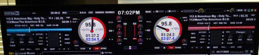

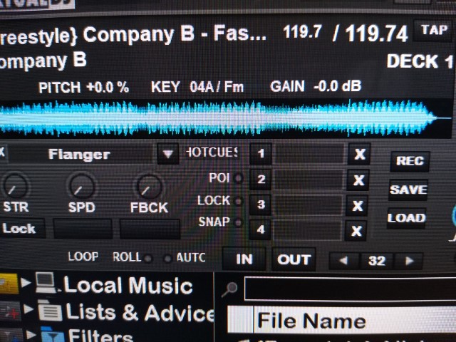

i see on almost every skin if you choose the waveform (Monochrome) it defaults to blue & red on the deck waveforms. im trying to do a ref theme. as in i want to make the blue side also red. i opened up the XML file & searched for monochrome & colored waveforms to see if i could find the blur hex color and change it to red but i dont see what anywhere in the lines that say monochrome ? please see my pics as to what im talking about thanks  (Small).jpg)
 (Small).jpg)
Posted Thu 16 Jul 20 @ 12:14 am

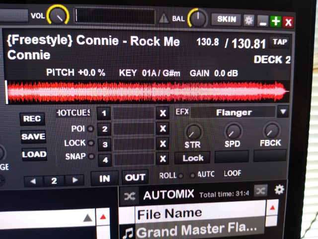

the skin im using is Controller by DennYO its one of the more popular skins lots of users use...here's what i have so far, just need to make that waveform blue. as im going for a red theme

i see on almost every skin if you choose the waveform (Monochrome) it defaults to blue & red on the deck waveforms. im trying to do a ref theme. as in i want to make the blue side also red. i opened up the XML file & searched for monochrome & colored waveforms to see if i could find the blur hex color and change it to red but i dont see what anywhere in the lines that say monochrome ? please see my picture as to what i'm talking about thanks
Posted Thu 16 Jul 20 @ 2:07 am
