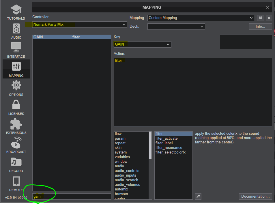

Ok my party mix is limited by number of pads but I could use 4 as I only need two main effect that I use echo+hq pass filter or lp filter (I loved using that on XDJ RX)
But I have a problem since my Numark Party Mix doesnt have Filter knob is it possible to remap my master gain knob for that? I want to try it out but I don't know how to program it.

          If the gain knob is purely a midi knob (not doing anything in hardware) you can do that..
Give it a try ;-)
In the mapper settings, simply search for "gain" and change the action to "filter"
