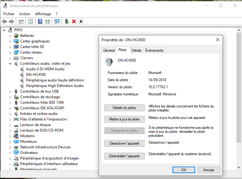

Denon DN-HC4500
And I had to change the VDJ option "exclusive AudioAccess" to "Yes" so that the channels (3-4) work in WASAPI
now channels 1 & 2 and 3 & 4 in WASAPI works Nikel

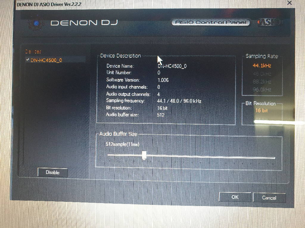

After trying again I was able to run 3.1.
everything works in 3.1, 24bits 96KHz, 16bits 96KHz, 16bits 441HKz cte ...

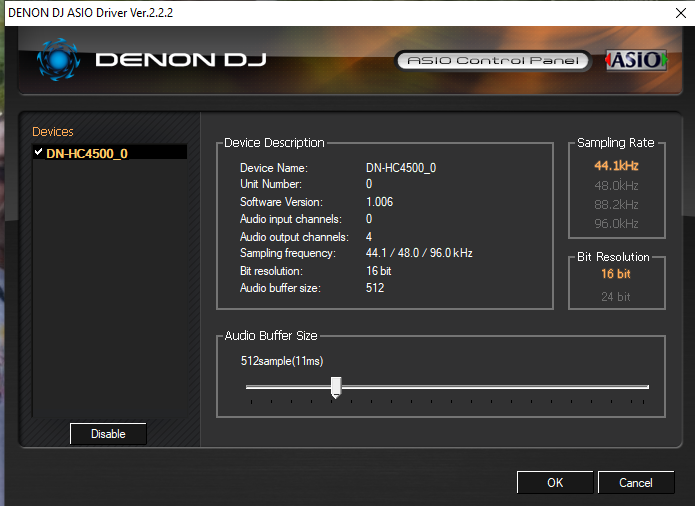

I only make it work in 16 bits only, 24 bits only stereo. Can you confirm your hc-4500 fabrication date and firmware version? It may be related so we can be aware of this too.
