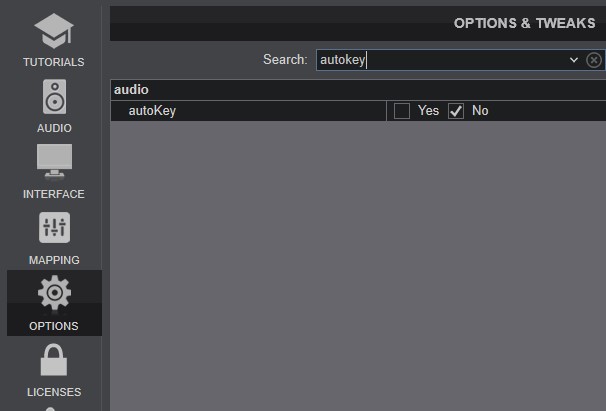

so turn autokey off?
Turning autokey off does not fix the problem. My autokey has always been off.
