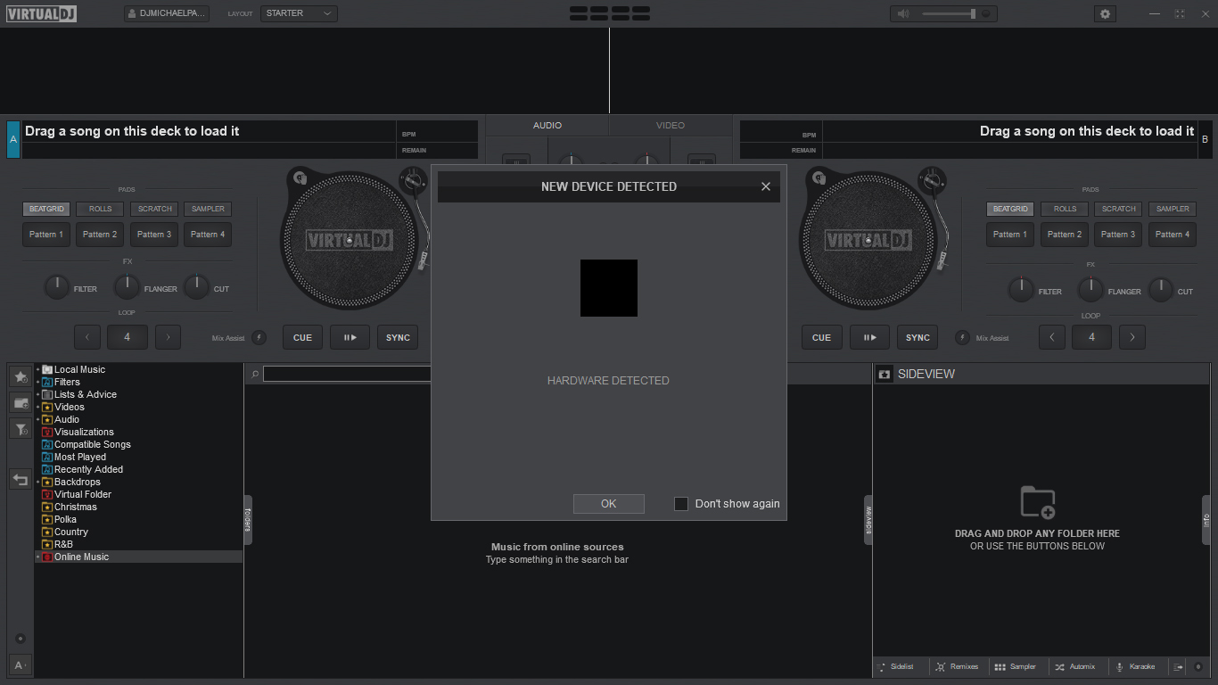

This week, Virtual Dj has started crashing and restarting multiple times a night at gigs. When it does, it completely clears my playlist and all of my settings revert to factory defaults, including the skin. This message appears saying there is new hardware detected. I have not changed any hardware in my setup.
