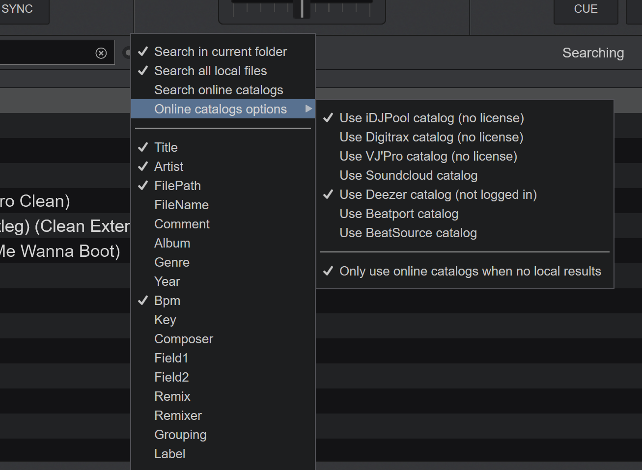

Which search fields do you have enabled?
Posted Sun 31 May 20 @ 6:21 am
search current folder
search all local folder
title
artist
filepath
bpm

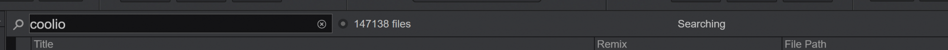

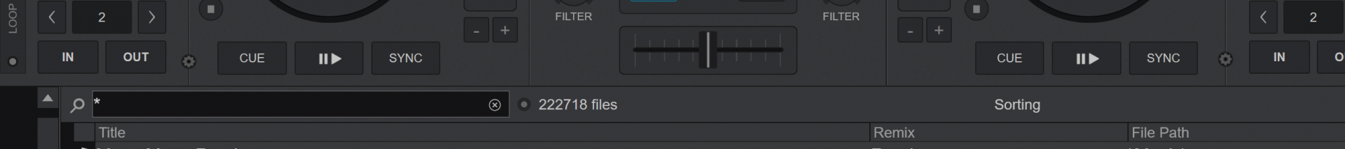

its been going crazy too.. as if I type word "test" it actually does a "*" and lists 220k files and sticks on Searching
then it will work or 15 min of sitting at "Searching" I close it and restart it... and its just acting up

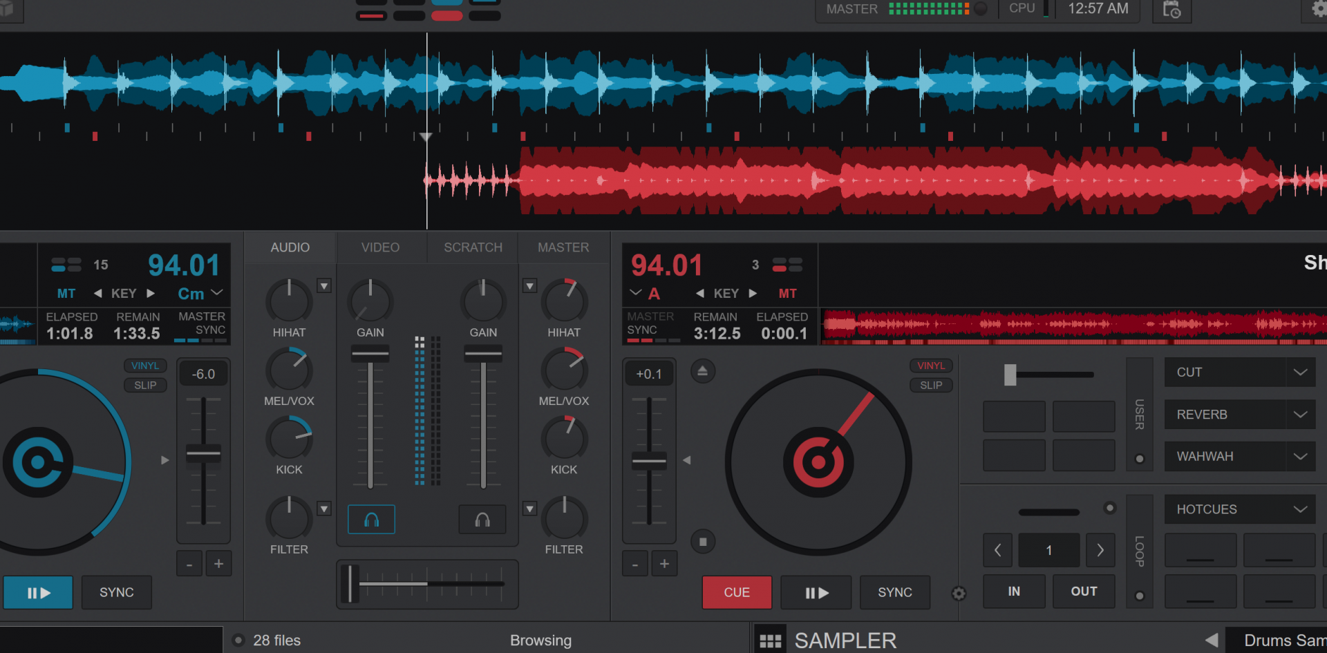

so I updated to the latesty virtual dj it asked me today.. and freezing up was just as bad well worse
after an hour of djing it starting going wonky with the datebase… then it got stuck for 1hr 40 min on "Browsing" I was not able to get out of it.. I forgot to take a pic of the time start and near the end.. I took a pic at the 1 hour 30 mark. so I had to do all the searching from Windows File Explorer and slide it into Virtual DJ... it would still play
but the damn "browsing" was stuck first it was stuck at Searching... and then browsing.. how can I fix this? I also have done the clean database... and then re add songs to the database
but whats going on is there something to test? why is it sticking in a endless loop.. and can there be an add on to force virtual dj to stop like a Control C to escape out of the loop like in Linux or so.... but I don't know why after an hour it then starts going wonky... did I search too many songs.. or what..
how can I fix it? sorry I didn't take better screen shots

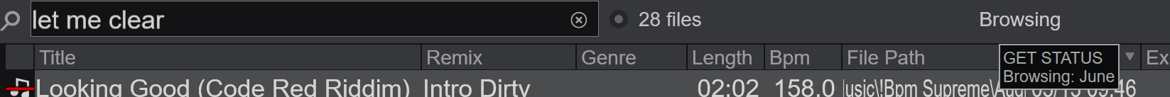

"June" is a folder, virtual folder or playlist?
Posted Sun 21 Jun 20 @ 8:59 am

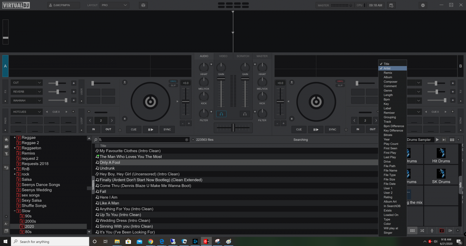

I see there's file date enabled in the browser too...
MC Pimpin you need to disable file date from the browser, because it will slow search down.
Posted Sun 21 Jun 20 @ 9:12 am
June is a virtual Folder for this month.. has like 30 files in it
so displaying file date slows it down? I can turn that off.. anything else

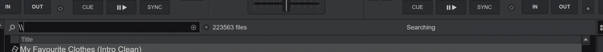

I just loaded up virtual dj and froze the software by searching "\\" didn't hit enter and now I cant get the search I removed couple search displays but she stuck
so from starting and just typing in the search.. screen capture and posting this... 20 min has gone by and its still stuck in the search.. I thinking something wrong inside my database or maybe there is a corrupt virtual folder inside as you guys only have a database cleaner/repair not a virtual folder repair..

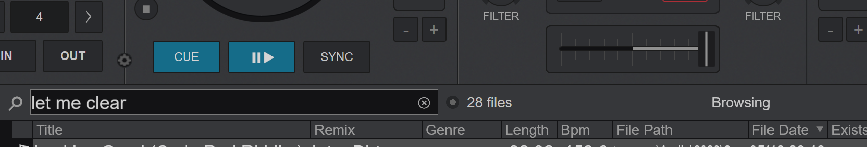

so I closed the program and reloaded it... I disabled everything but Title and Artist.. but you can see in the display it only Shows Title doesn't show artists..and I tried the "\\" just to type no hitting enter.. and it stuck in the Searching mode

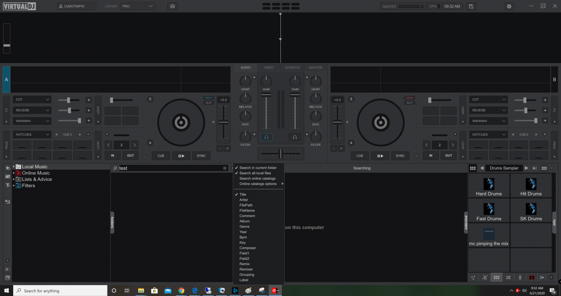

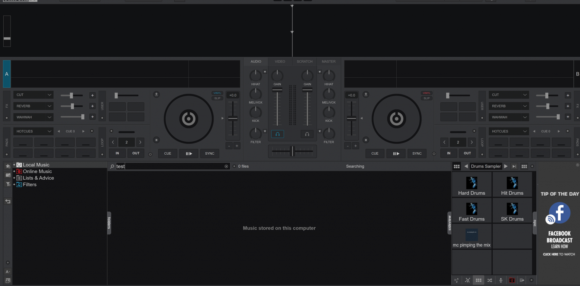

so I just tried now
I renamed the Virtual DJ Folders Folder to something else so it wouldn't load the Virtual Folders
I typed in Test and it stuck in an Endless Searching loop and no files from the database
actually it went into endless loop by me just press "T" for the word test
I closed program reloaded I disabled all the search except title as you see and its stuck in searching loop
only should be searching the 2 database's 1 is 5 meg in my documents folder I still need to process lost links... and the under 200 meg database file on my X: I moved everything to.. and its on an Enterprise 12TB hard drive 7200rpm 512meg cache so plenty of speed etc
Posted Sun 21 Jun 20 @ 1:37 pm

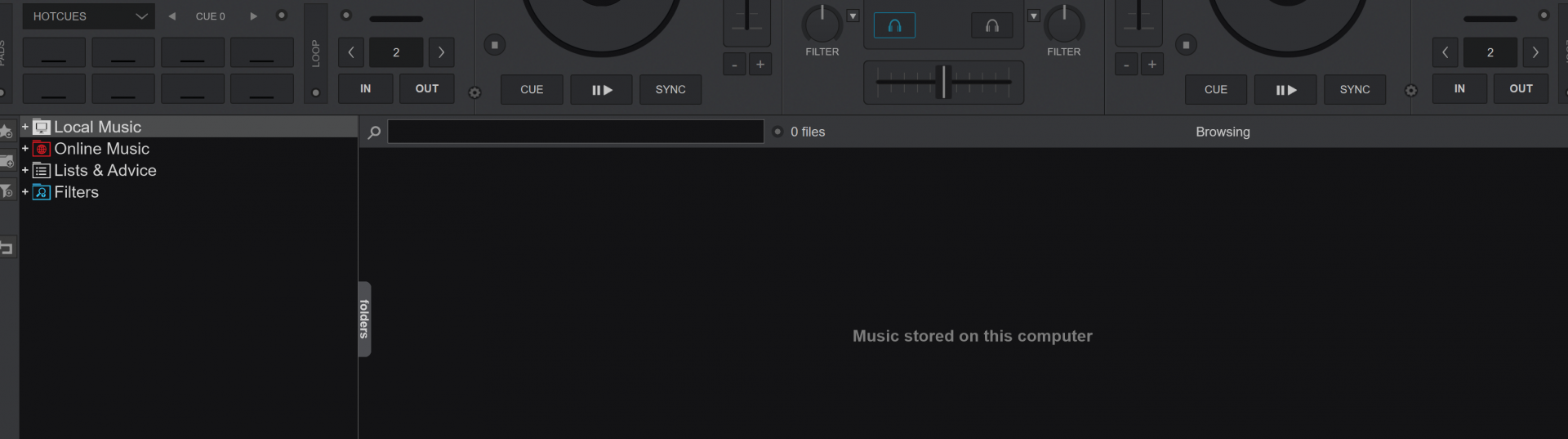

and while in endless loop you see the tabs on the left like Local Music etc are unclickable they are frozen
well you can Click on the 4.. you just cant Expand them.. they locked

now im in and endless browsing when I clicked on local drives to expand it like I mentioned

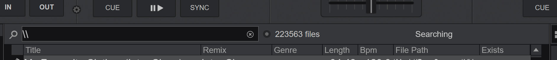

I forgot to add the reason I did the "\\" in search I noticed other day one of my file paths showed up like "\\?\x:"
so I was try to find itmust be saved in the virtual folders like that

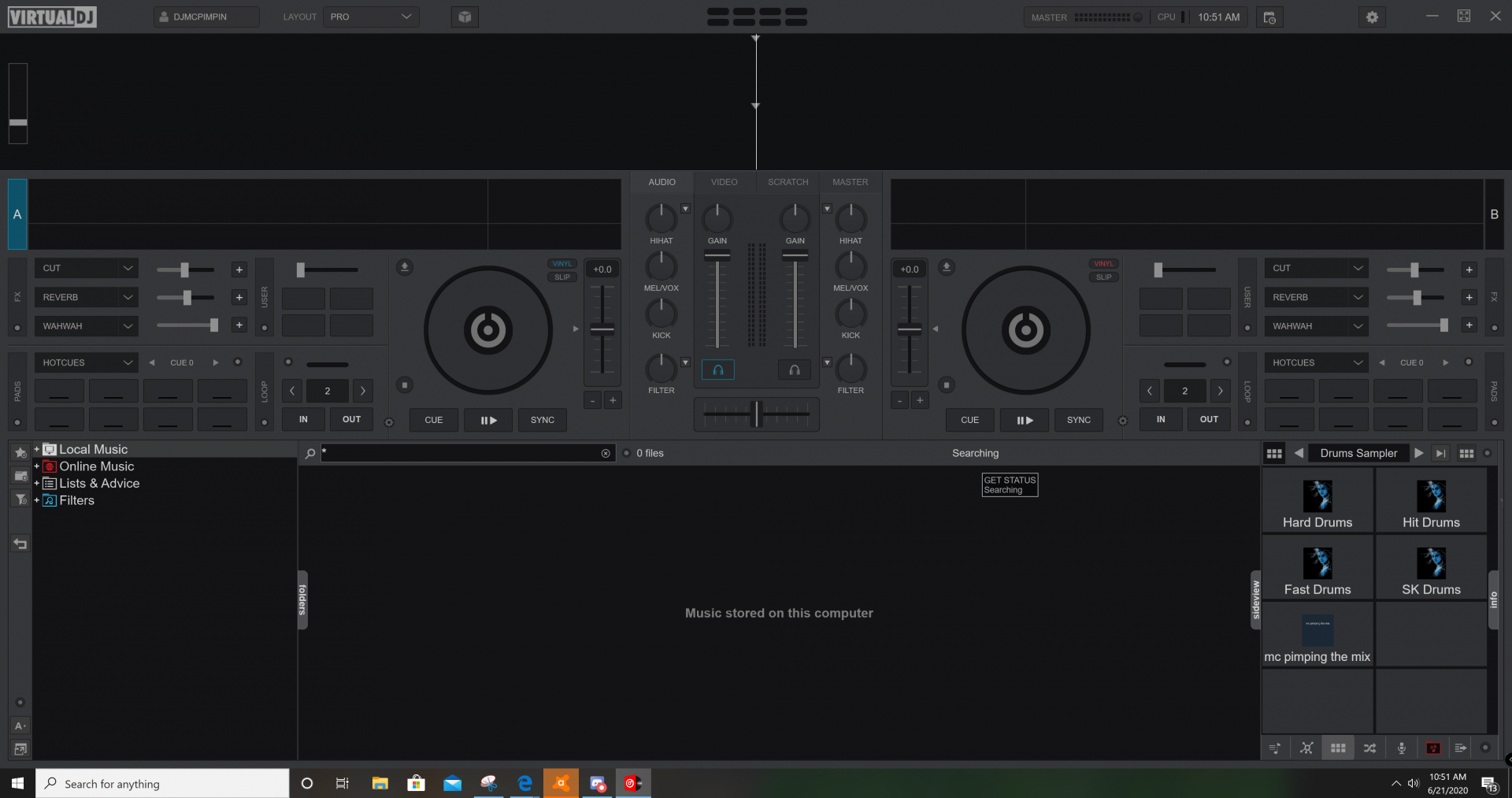

update 3
I did the search "*" with 5928 version and still locked up frozen

update 1.
I have switched from different HD enclosures. different brands of Hard drives, Usb speeds up to USB C and it always hung up at the club I was working at last year..
I also figured it was the virtual folders but I thinking something wrong in the database... as I noticed today its even worse on the hanging and now it hangs no virtual folders.. ill try again after the database searching missing links is done only 50% done
update 2
so it did the 100% clean no change it looks like.. I tried to search it froze.. I did a reboot and its doing another download update
8.5-64 b5926 currently using this version
once its done downloading ill retest.. it seems more updates my locking up is getting worse.. its getting more sensitive must be something in there that has invalid info
like I mentioned the "\\?:x" location I noticed
update 3
Posted Sun 21 Jun 20 @ 2:02 pm
guessing after so long you cant edit your post so I had to do another..
update 4.
I closed the program. restarted.. instead of searching.. I just went to Local Disks and recurse the music folder it least can do that ok.. displays the files
so I waiting for it to process I re did "add to search database " my music collection folder.. to see if it will lock up
I still have the Virtual Folders removed its just the 2 Database's 181meg (X:) and the 5 meg (Documents)
update 5.
so after the add to search database.. I did "*" and in past used to be instant... now its also frozen
its stuck in Sorting endless loop now.. its been about 10 min that its stuck in this mode.
after 10 min I reloaded and I tried "Coolio" for a search its now locked up been 5 min at this screen
I have no tried yet removing both database's for the time being and re add the music from scratch.. guess ill test that.. because in the end I don't wanna loose all my cue points
update 4.
update 5.
Posted Sun 21 Jun 20 @ 3:09 pm
