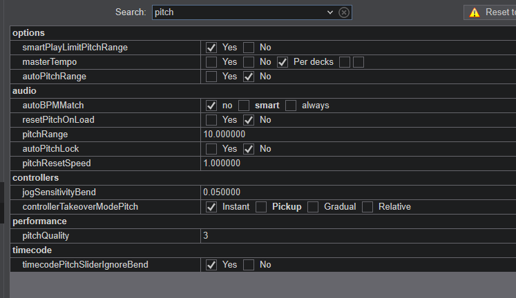

I've turned Auto everything OFF, went into Settings and adjusted pitch till the best ability.

You can usually get an idea of the signal quality looking on the timecode tab in config and see what it looks like.
