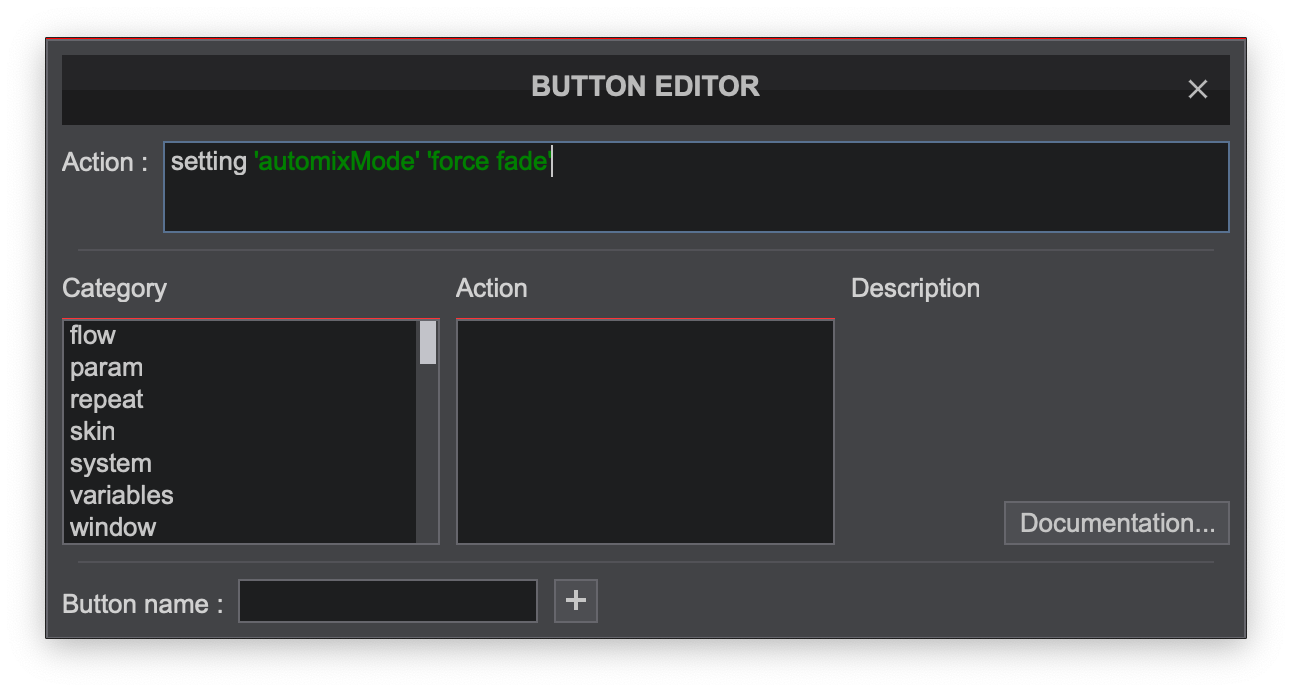

setting 'automixMode' 'force fade''force fade' can also be:
'smart'
'skip silence'
'full song'
'no mix'
'radio'
setting 'faderLength' 4Change the 4 into how many seconds you want.
All can be assigned to custom buttons.
Posted Fri 15 May 20 @ 10:20 pm

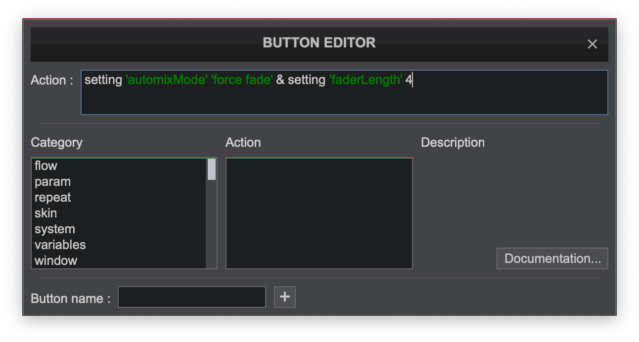

Are you writing the custom button including the word 'setting'? Like this:
And yes you can combine the actions using an '&' symbol, like this:
Posted Sun 17 May 20 @ 11:47 pm
