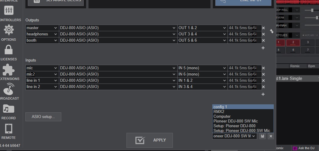

Can anyone explain to me what the DDJ-800 SW Mic option is for? I attached a picture. Look at the lower right hand corner.
Is this option used to send a mic signal to the internet via usb? If not, can someone tell me what it is for?

That's exactly what I thought. I am trying to send a broadcast signal with music and my mic. I have SW mic selected, but it's not transmitting my voice over the internet. I can't figure out why. (Scratching my head)

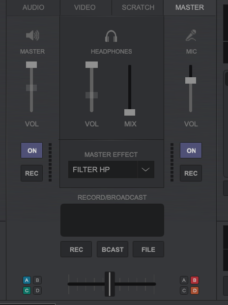

Little unsure when it comes to the software vs hardware mode control
When software mic, are you enabling and controlling the mic in the software ?
At master panel at the mixer section, turn "ON" for example
Although, the controller itself might also have on/off that works for software mic too.. See #24 here:
https://www.virtualdj.com/manuals/hardware/pioneer/ddj800/layout/mixer.html
Posted Sat 25 Apr 20 @ 5:02 pm
Yes. It's turned on in the Master section and I also turned it on physically on the controller just like in the picture. (Still scratching my head)
Thanks for your help. Please let me know if you think of anything else. I am wondering if it is a routing issue now on this page:

Rune!!!
Nevermind! You were right! I didn't have the software mic turned on as displayed in your picture. Just turned it on and bam!!! It's working perfectly now.
THANK YOU SO MUCH!!!
Posted Sat 25 Apr 20 @ 5:14 pm

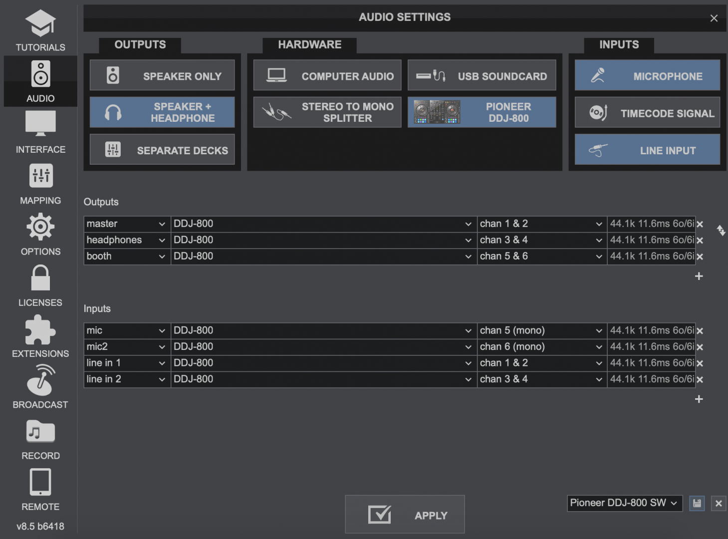

Hi guys,
Need your help here, I have same microphone issue with my unit. Using Mac pro and here is the setup config screen shots

Did you set mic mode to software? DDJ800-micMode
https://www.virtualdj.com/manuals/hardware/pioneer/ddj800/settings.html
