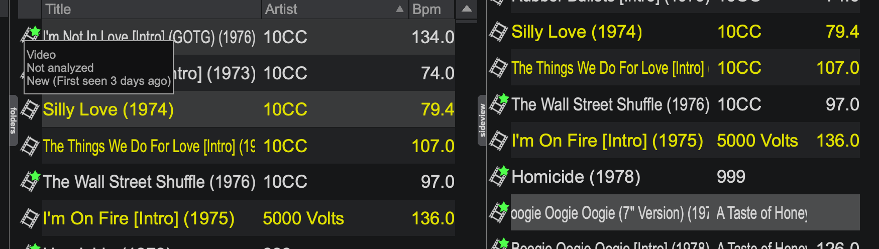

I installed the latest vdj update a few days ago and now they don't save the colour code in the playlist or the bpm's when I shut down and re-open vdj.
I have been colour coding my main decade playlists for over a year now without any problems. eg - 70's are coded yellow, 80's are coded magenta etc!
Only a small percentage show with the colour I previously saved them in.
Any particular reason for this and what is the fix?
Thank you
Photo shows only a small number keep the colour code after I have re opened vdj and quite a few don't save the bpm's from previous time also.
Thank you

Hi, any changes i make on tag editor are only saved while vdj is open. When I close and re open, the changes are gone. The colour code is gone, the bpm is gone and any info I've changed on song description. Nothing seems to be saving since I updated a few days ago!
When I add songs to a particular playlist, that saves without a problem but no info change on the tag editor is saved.
Before i updated, my entire playlist for 70's and 80's were colour coded and saved without any problems. I can't even revert back to "no colour ", as once again, nothing is saving!
There was also an update for macOS Catalina a few days ago too. Coincidence??

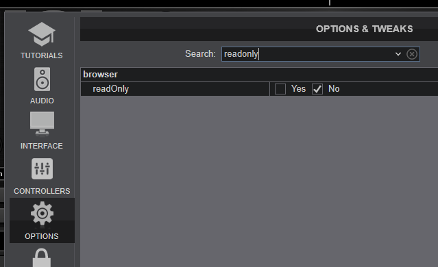

make sure this setting is off as well

I see that all tracks that don't keep their color are also marked as "new" tracks.
Is there any chance you made any changes to your files outside VirtualDJ and therefore it lost the connection with them ?
In other words, is there any chance you moved or renamed any files or folders outside VirtualDJ ???

Thanks for your replies.
The read only is switched off.
Just double checked to make sure and some unknown b*gger must have turned it on,lol. It's off now and we are all good.
Got some nice colours for my playlists,lol.
