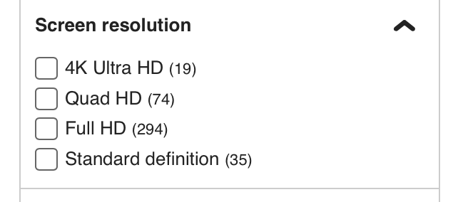

I would never (in 2020) consider purchasing a laptop with anything less than an HD (1920*1080) resolution.
I'm not suggesting that everyone rush out to purchase a new laptop. But most DJ's would keep their machines, up to date and well spec'd so in the not too distant future full hd laptops will be the norm.
In fact a rudimentary search on PCWorld/Currys (in the UK) reveals that only 8% of their entire laptop range has a resolution below full HD.
Plus what you also have to bare in mind that some laptops support 4k. Can you imagine how poor a low res skin on a 4k screen would look.

I've been over this before, but....
It's not so much the resolution, but the screen size. Doing the same check as you, 15.6" is still the most common size.
