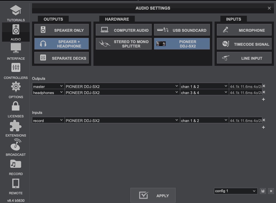

OK so now what's your audio config? Is it the default one for the SX2? Please post a pic.

Here is the audio config settings from VDJ
Posted Sat 11 Apr 20 @ 3:58 pm
Looks OK to me.
