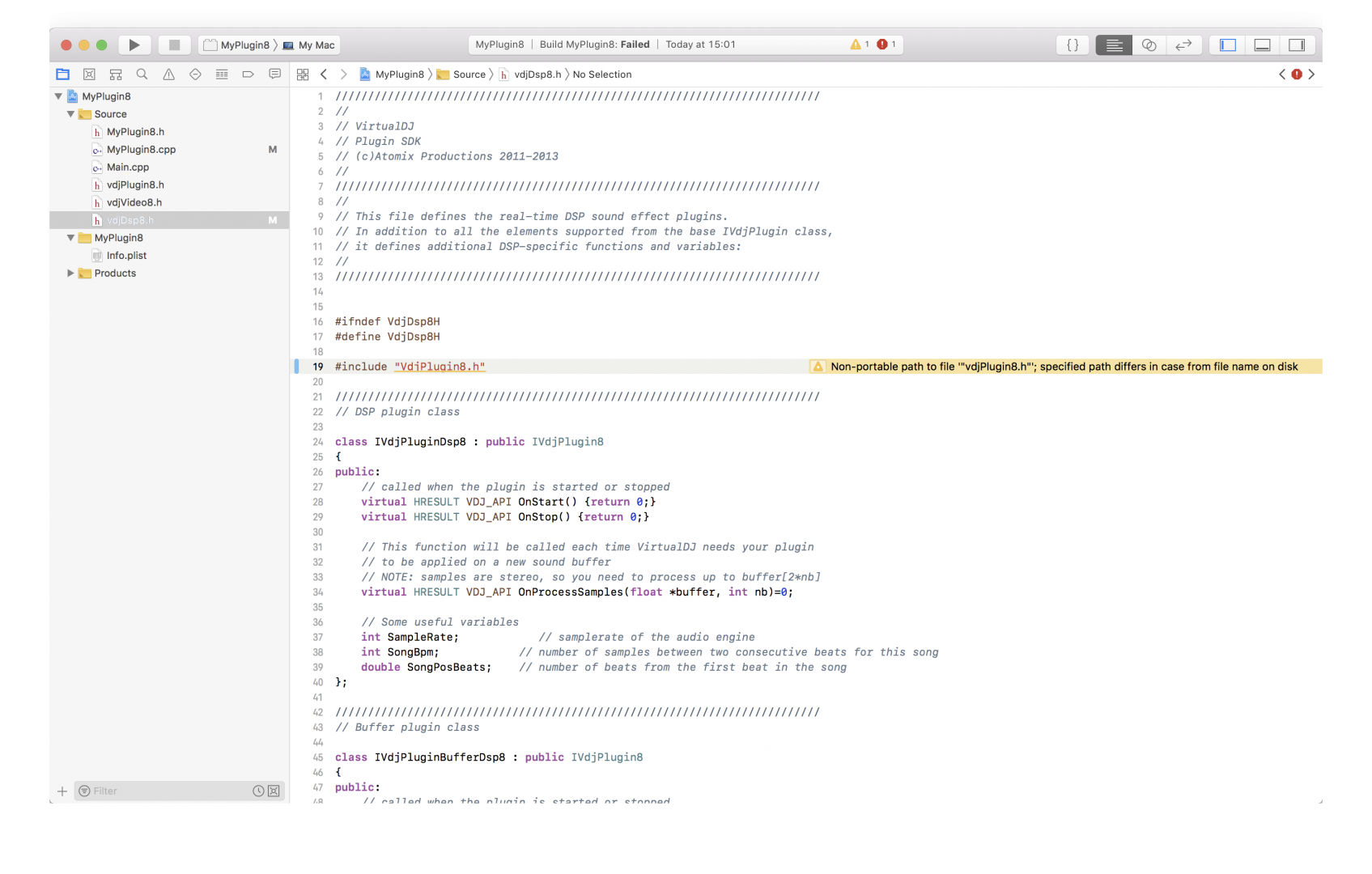

I started experimenting with code samples from https://virtualdj.com/wiki/Developers.html and I noticed the following issues when building plugins from samples:
in vdjDsp8.h from SDK there is warning
Non-portable path to file '"vdjPlugin8.h"'; specified path differs in case from file name on disk
https://virtualdj.com/wiki/Plugins_SDKv8_Dsp.html
Can you replace VdjPlugin8.h with vdjPlugin8.h?

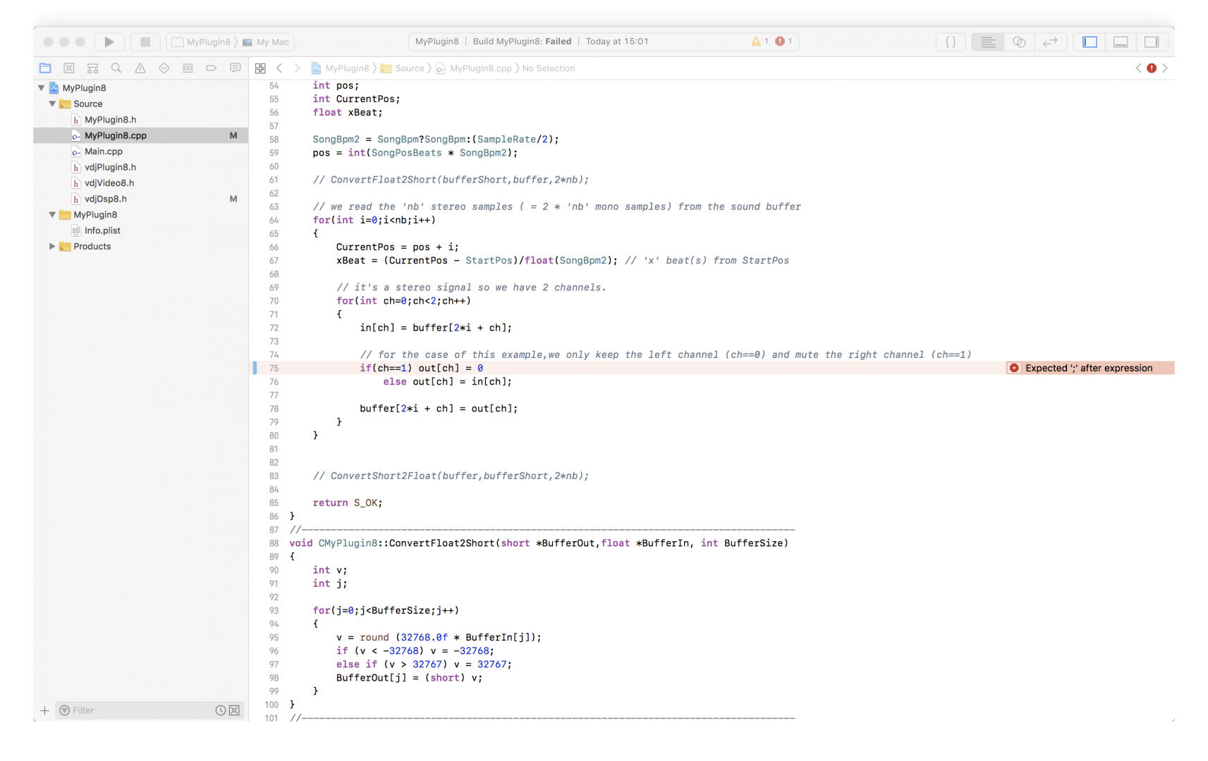

In MyPlugin8.cpp from https://virtualdj.com/wiki/Plugins_SDKv8_Example1.html
there is missing semicolon at the end of line containing: if(ch==1) out[ch] = 0
and build fails because of that. Can you update this sample on your site?

Thanks for adding missing semicolon to sample. I noticed configuration for Visual Studio, but I haven't seen anything for XCode.

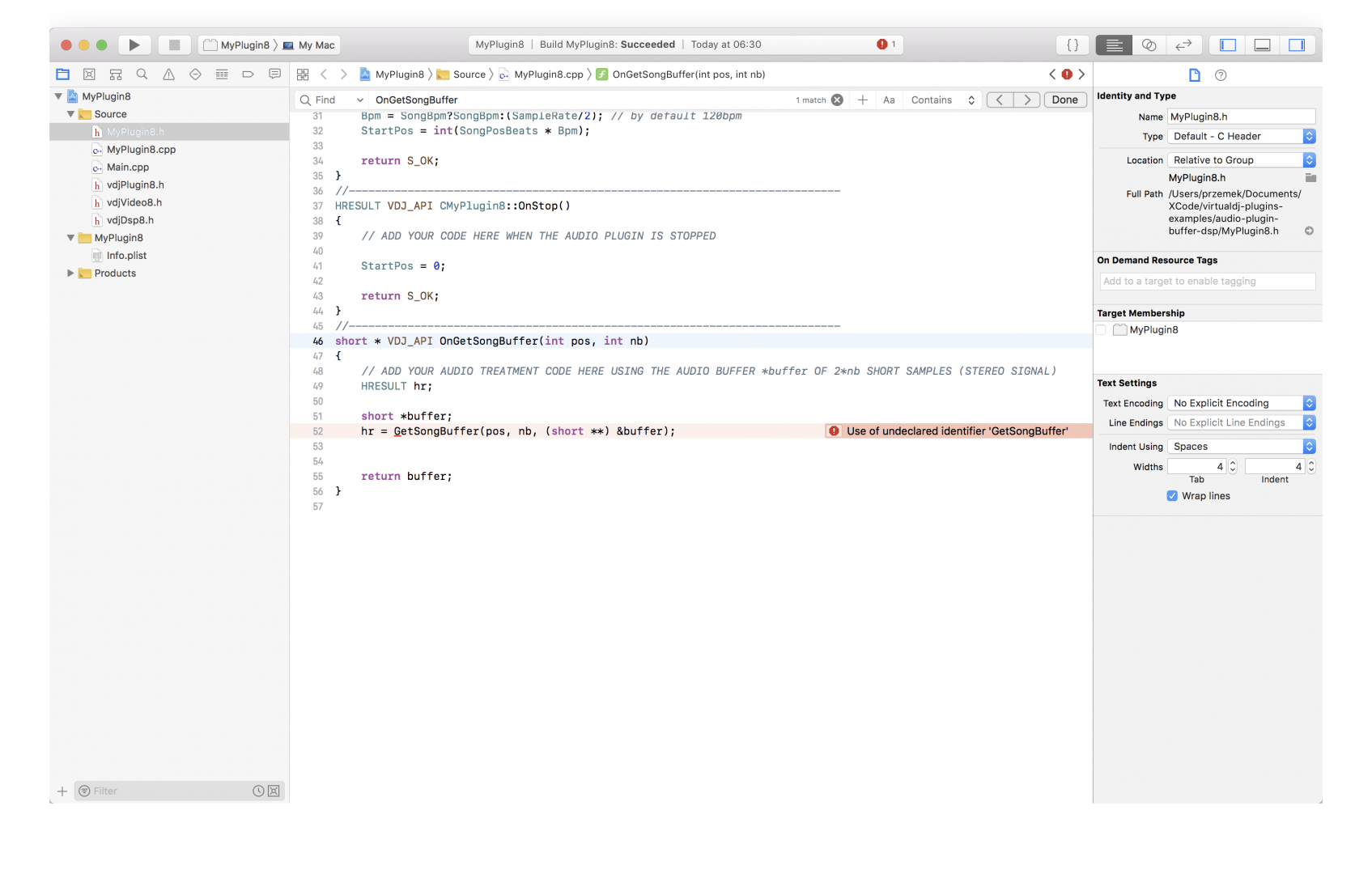

I discovered an issue in other sample https://virtualdj.com/wiki/Plugins_SDKv8_Example6.html
In MyPlugin8.cpp there is error `Use of undeclared identifier 'GetSongBuffer'`
Can you replace:
short * VDJ_API OnGetSongBuffer(int pos, int nb)
with:
short * VDJ_API CMyPlugin8::OnGetSongBuffer(int pos, int nb)
After that change plugin is going to build successfully.
