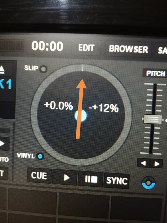

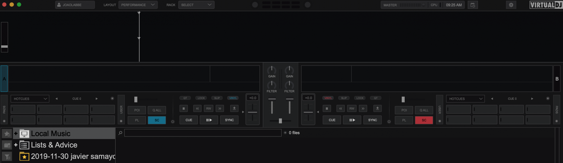

Denny DennYo wrote :
I don't get the problem in the video fixed. We have to live with that.
stlvs wrote :
I've done everything,can't figure it out.. I guess I'll have to wait till next update..Cheers
https://youtu.be/GQwJ9_TeU1I
The problem is that when I change any setting the folder browser and the main browser returns up to the beggining..That doesn't happend in any other skin,inclunding yours,but as you said,we could live with that
Posted Mon 30 Mar 20 @ 12:21 pm
It is because I worked a lot with the new function "condition". This increases performance because not all script parts work in the background. As a result, the skin must be reloaded when changing the settings.
Posted Mon 30 Mar 20 @ 12:32 pm

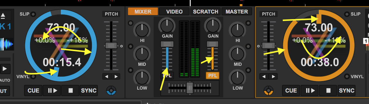

Were is the color info in your (Skin.xml) I would like to change them to the same color and make the % with a darker color.
Thank you Dj
Posted Mon 30 Mar 20 @ 1:18 pm
Thank you Dj
For the DECK specific colors (blue, red, green, orange), search the tags under
--color-define-light-gray-blue-red--
--color-define-light-gray-blue-yellow--
--color-define-day- blue-red--
--color-define-day-blue-yellow--
--color-define-dark-gray-blue-red--
--color-define-dark- gray-blue-yellow--
for example:

Something like this (no Jogs) and with a darker (black) skin as in this photo
Posted Mon 30 Mar 20 @ 3:29 pm
Sorry i don't understand this.
joaolabbe wrote :
Hello Great update! Ia m asking if possible, can you make or how can I make the dark black skin mode as in the default's news options. Also is there an option to remove only the jogs and keep everything else as it is( in default performance view small) thanks.
jll
jll
The color chage is very easy, but chage the layout is many hard work.
Posted Mon 30 Mar 20 @ 3:39 pm

Yes that litle blue stripe on the left deck everytime VDJ opens
*Keep safe my friend!
