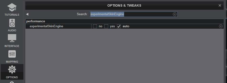

There are no Chinese chars. I think this are rendering problems. I see you have shrink the Skin to a resolution smaller than 1920x1080 and not 16:9. The Platters are oval and not round.
(The problem with the Oval shrink comes from my Breaklines. i will change this soon)
You can test the VirtualDJ Option experimentalSkinEngine
@Tasos

how to fix the resolution of the skin?
i test the VirtualDJ Option experimentalSkinEngine same....

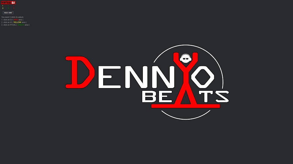

Wie komme ich jetzt wieder aus der Nummer raus ???
Ich meine damit, das ich folgendes Bild auf meinem Monitor habe
und nix mehr machen kann. Wie komme ich jetzt wieder zurück zu dem normalen Bild von VDJ.
Bin zu Hause am PC und habe keinen Controller angeschlossen.
Was mach ich jetzt ????
Posted Sat 29 Apr 23 @ 5:08 pm
I wrote the awnser in the german Forum at your post.
You can also find the awnser on this Topic. Go one Page back.
https://www.virtualdj.com/forums/170146/German_Forum/Neue_Skins_by_DennYo__).html?page=52
Posted Sat 29 Apr 23 @ 5:18 pm

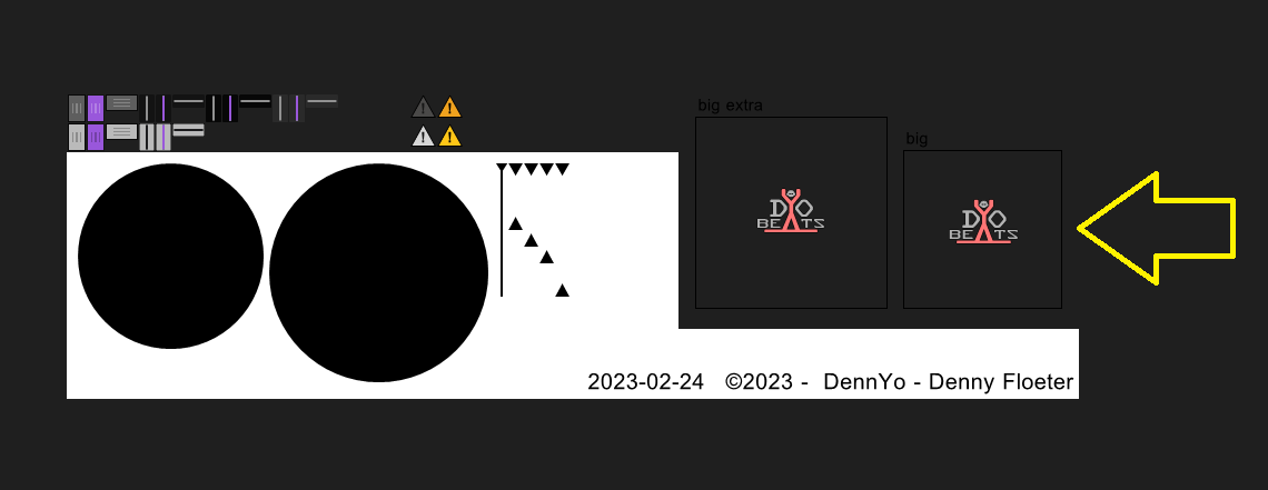

Look inside the Skin.zip.
The img.png has changed.
You must edit the new img.png.
Posted Tue 16 May 23 @ 6:11 pm

i have done this but with the latest update it will not show my logo as befroe??????
DennYo Beats wrote :
I add for the next update an function to add your own "on jog logo". I add an area in the img.png. I think the update will upload on the weekend.
show here:
wwwimmjcom wrote :
First, love all the version you have made! Thank you for all the great work! Question, I was able to add my logo to the jog wheel on most skins including HD by DennYo. Have not been able to add it on the stock 2020 skins or the Controller 2020 skin. Is this something with the new VDJ 2020 that makes the jog wheels area un-editable?
show here:
Posted Wed 31 May 23 @ 8:13 am

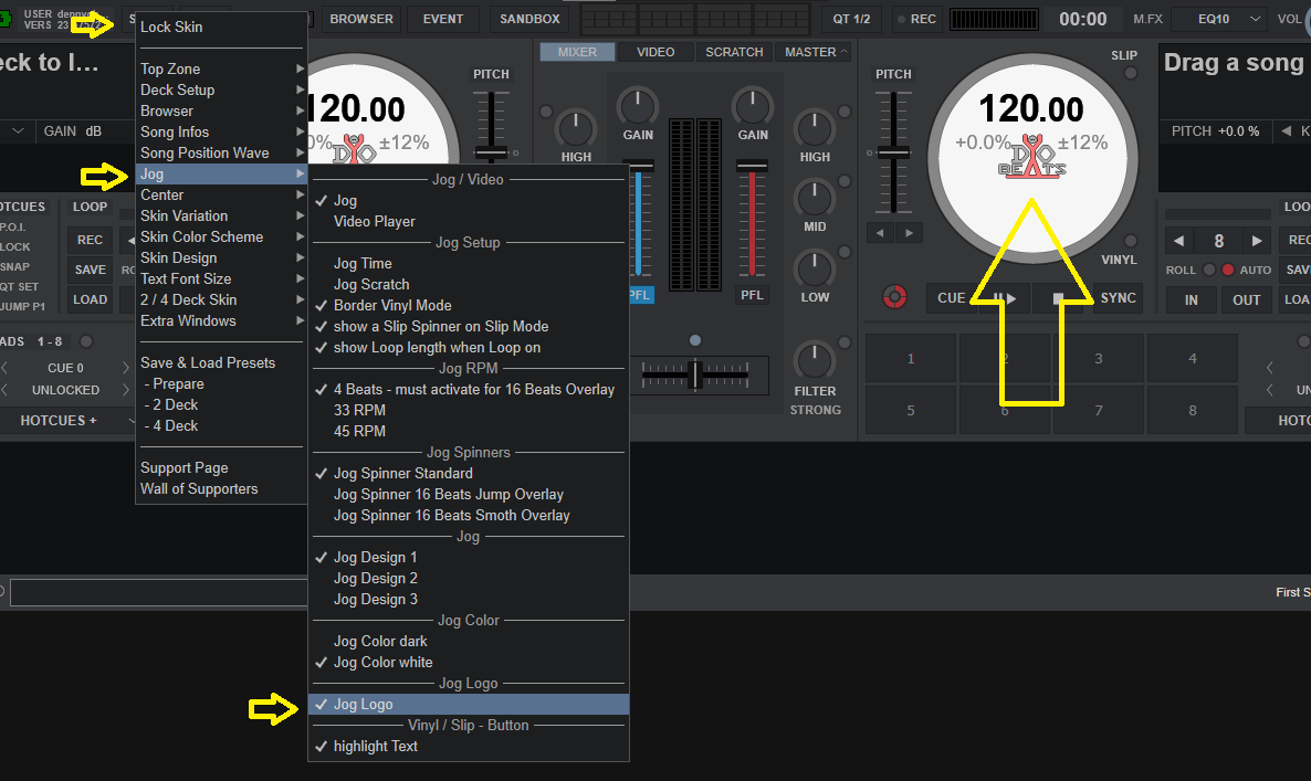

Version 3.4.1
The Logo works...
I do not understand your problem
The Logo works...
Posted Wed 31 May 23 @ 11:10 am
