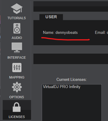

The problem is. You must change this after any update from me. When you send me your VDJ Username and the two lines with your changes than i can add this for you. And only you have the changes. Other Users have the normal blink. The Wave blink (15 seconds) on Automix is an Bug from me. I have deactivate blinking at Automix, now.
You can find the correct Username on VirtualDJ Settings/Licenses

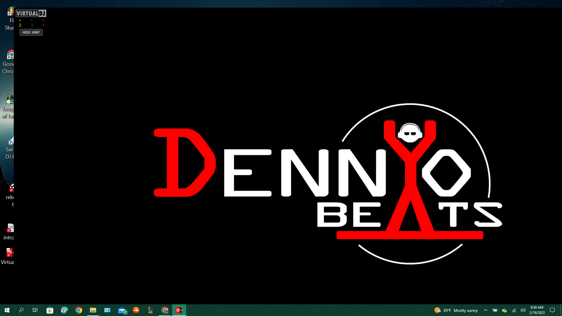

I noticed there is a lock button at the top of the scrren, I clicked it and it locked the screen with just a display that says Dennyo Beats etc. I cannot for the life of me figure out how to unlock it. Closing the program and repoening did not work. Need some assist please and thank you :)

You need 3 clicks to unlock:
1. click on DJ (RED area)
2. click on VI (YELLOW area)
3. click on RTUAL (GREEN area)

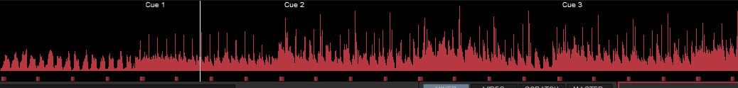

I find something strange in v3.3.8 skin.
I am missing the 'vertical line' [marker] for CUE-points, in ClassicWave Overlap.
I cannot see the 'vertical line' [marker] to see where the CUE-point is exactly.

Version 3.3.9 - 2023/02/28
Bugfix - Cue Marker on the Classic Wave wasn't visible
