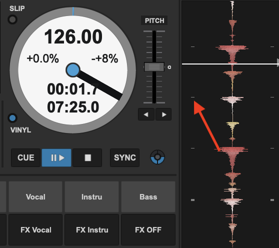

Is there a way to change the color of elapsed time only, on jogwheel?

Since there's a lot of information on the dial, that has same 'size' text, same colour, etc...
it's a bit of information overload for me, so I just wanted to create some difference in size & colour of that text.
What I would like to know is, how to change following:
- size of BPM text on jog-dial or even colour?
- change colour at least (or size by slight difference?) the "elapsed" time.

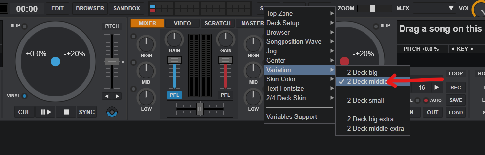

Danke dir DennYo.... Es ist also nicht möglich die großen Jogs ohne die Pads zu haben?
Posted Tue 22 Jun 21 @ 3:02 pm
Doch, nimm mal "2 Deck middle extra".
Posted Tue 22 Jun 21 @ 3:06 pm
1+. ..... Danke Dir

Hi DennyYo,
I came across your VDJ skin that I start to like very much because it is really customizable! All that is missing to the default skins from VDJ's ;-)
However, I'm missing 1 and only 1 element that I'd like to customize:
On the 'scratch' waveform, I'd like to make the beat markup more highlighted than the current grey version on your skin (cfr PrintScreen . Ensure that it si easy to see even from a couple of meters away from the laptop..
May I ask you for any indication on where to change size and color within the XML?
thanks a lot!
nicolas
thanks a lot!
nicolas
Posted Sun 04 Jul 21 @ 5:30 pm
these are parameters of "<grid/>" child of "<scratchwave/>" elements
<grid pos="" height="" size="" mainsize="" maincolor="" color="" color2="" mirrored=""
background="" backgroundshaded="" backgroundcolor=""
shapepos="" shapemirrored=""/>
https://virtualdj.com/wiki/Skin%20Scratchwave.html
Posted Mon 05 Jul 21 @ 2:58 am
