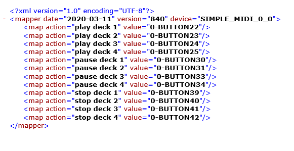

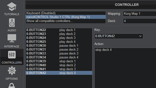

I have added some screenshots. At this point these buttons all work but they all work only on the same deck which would be the deck I load the last or most recent song on. In this case it is deck 1 that's highlighted.
I haven't added anything else yet for the moment. I have had the levels working before as well with the same results. Everything works but only on the last deck loaded. As for the pfl I can always get it to turn on but not to turn off which I think would be a toggle button but I haven't bothered as I cant get past this point yet . I have tried "select_deck" and "action_deck" and dozens of different syntax orders but it always ends up doing the same thing. All the buttons control the same deck and yes I am changing the "deck" dropdown as I type each line.
I know I am missing something here but have no clue as to what.

your actions are backward, spec the deck first
deck X play
deck X play

Amazing.....you have no doubt seen the smiley face banging his head against the wall?
I walked in from work saw the post and 5 minutes later I had all the main things I was after and now I am working on the extras.
A million and one thanks locodog. That's the one thing I hadn't tried. Amazing how fast we lose something when we don't do it often. I'm sure that's the same thing that went wrong when I tried the qu16 too.
I am going back for more now. Thanks once again.

also leave the deck dropdown as "auto" that isn't a line by line thing, its for the entire mapper
