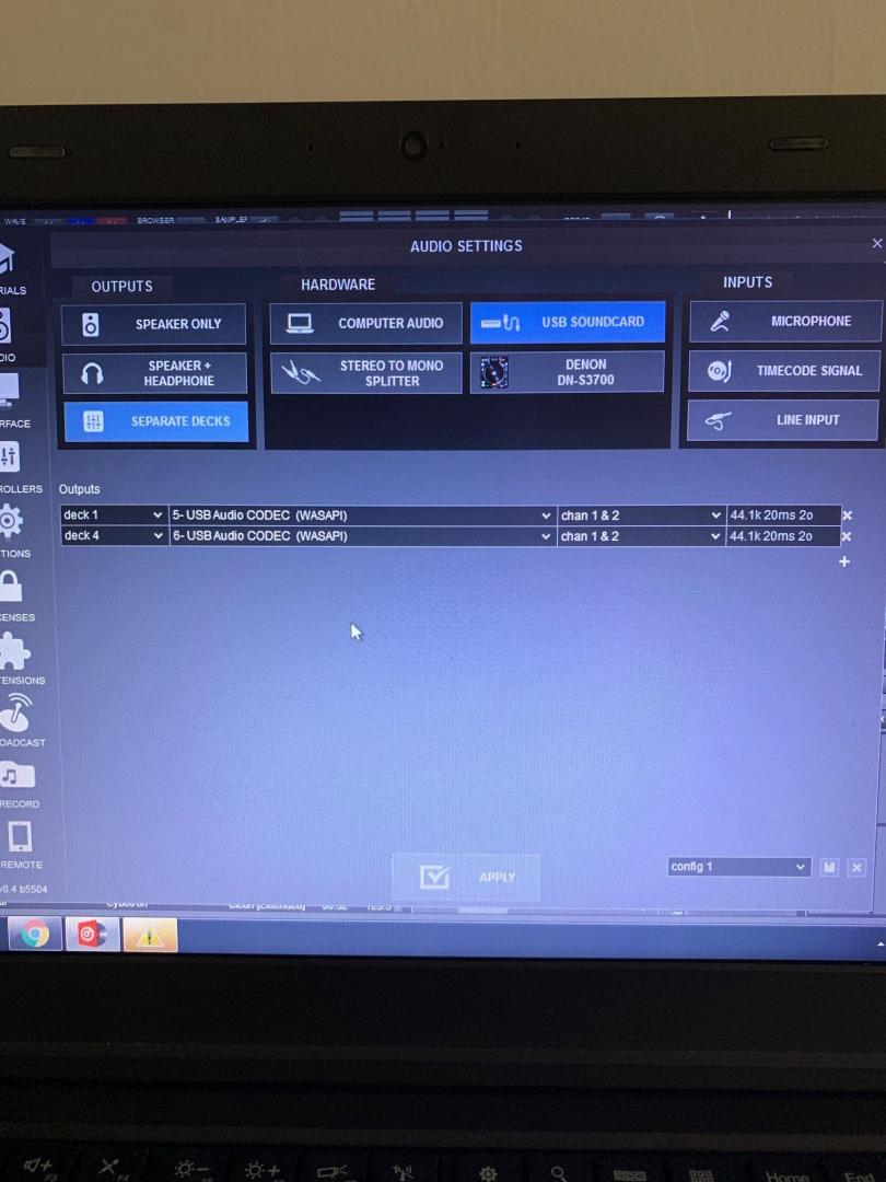

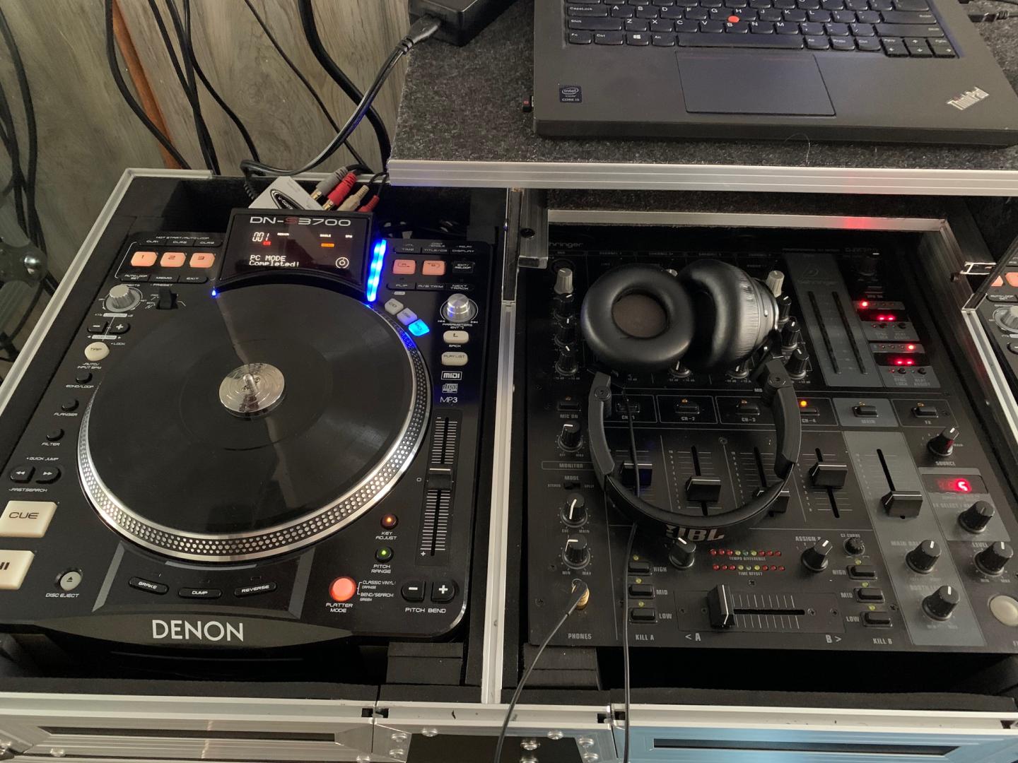

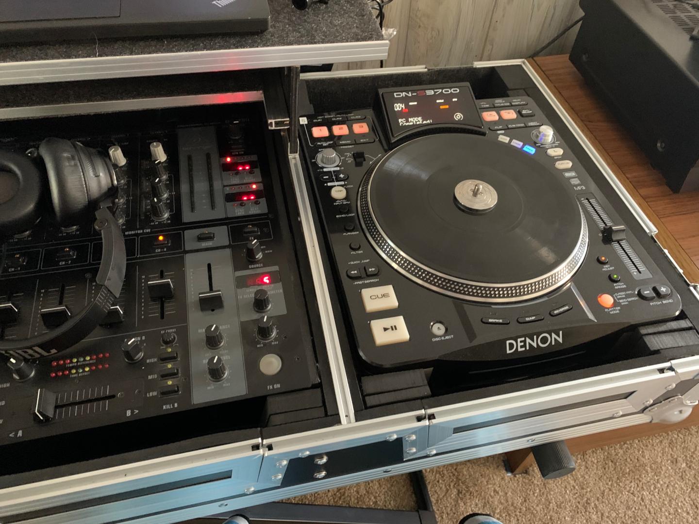

a picture of your audio config and any info on what hardware if any you're using

Posted Sun 16 Feb 20 @ 3:48 pm
When you're using a "separate decks" or "external mixer" setup, the internal (on-screen) VDJ mixer is not used.
If you try to podcast or record a mix, then the signal is taken from the output of the internal (on-screen) mixer - that you are not using.
You need to send the podcast signal from the output of your real hardware mixer.
Please read the help page:
http://www.virtualdj.com/wiki/Recording%20your%20set%20or%20broadcasting%20when%20using%20an%20external%20DJ%20mixer.html
