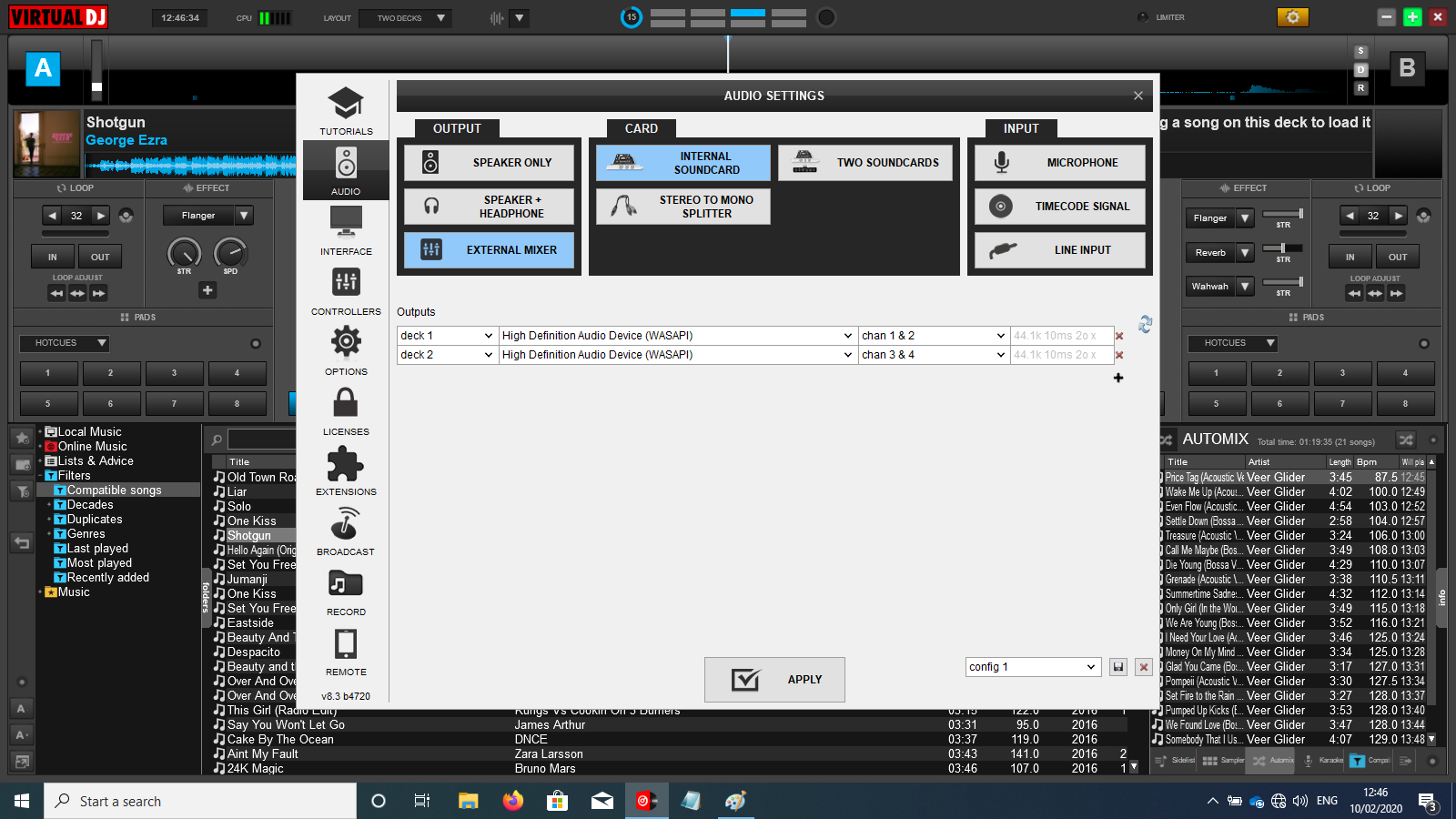

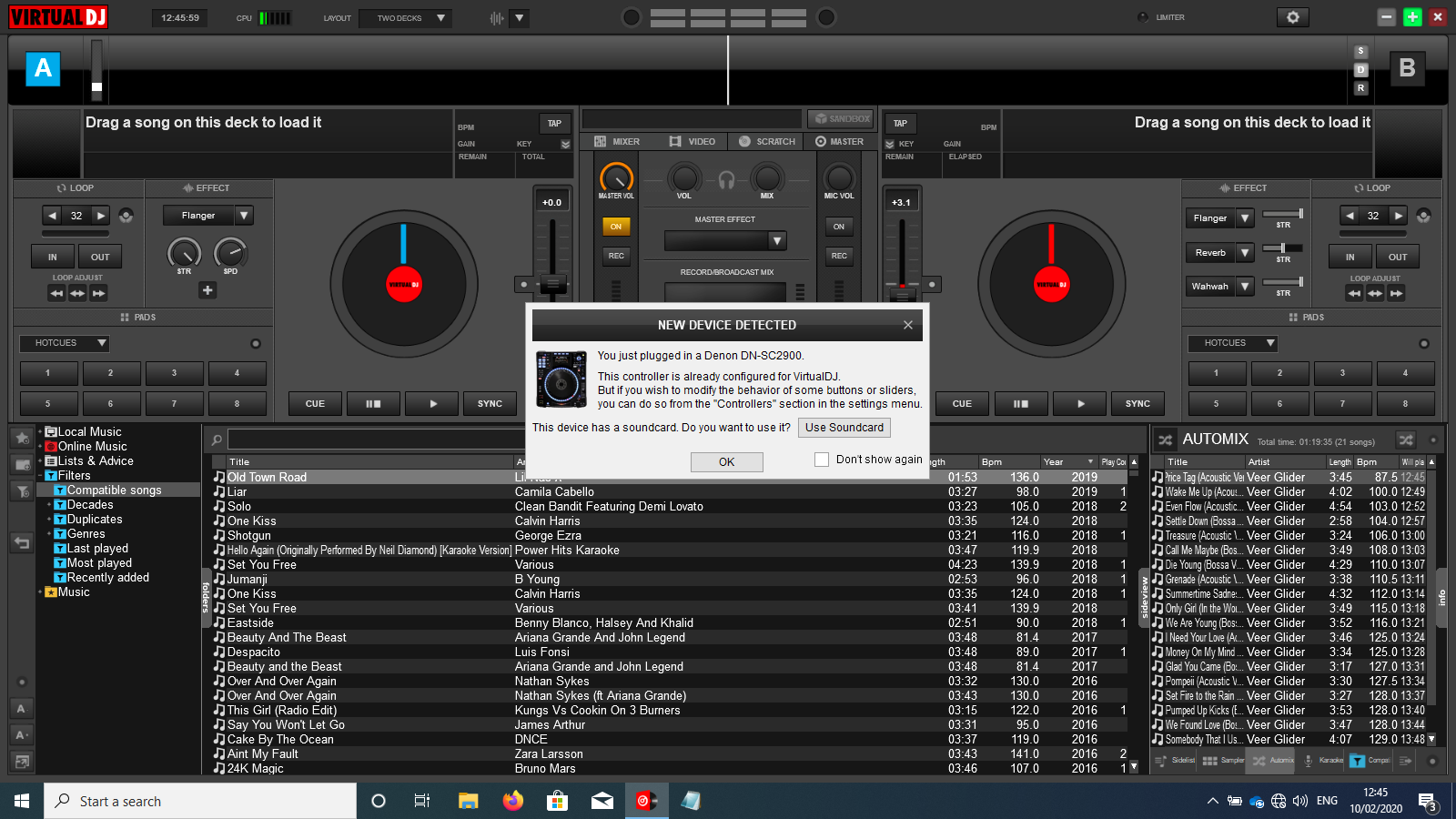

I've just swapped to a new W10 laptop (from W7) and changing to VDJ2018. I'm struggling to get audio via the SC2900s.
So, I've clicked "Use Soundcard" at the Startup screen.
Audio settings are as below
Deck 1 plays through the laptop speaker. Deck 2, no audio from anywhere. The track does 'play' though, unlike V7.4 when the settings are in-correct.
I'm guessing I'm missing something real simple/silly.
Any help appreciated.
Note, MIDI control functions operting as expected. i.e. Play, Cue, Scroll, Select, Pitch, etc etc

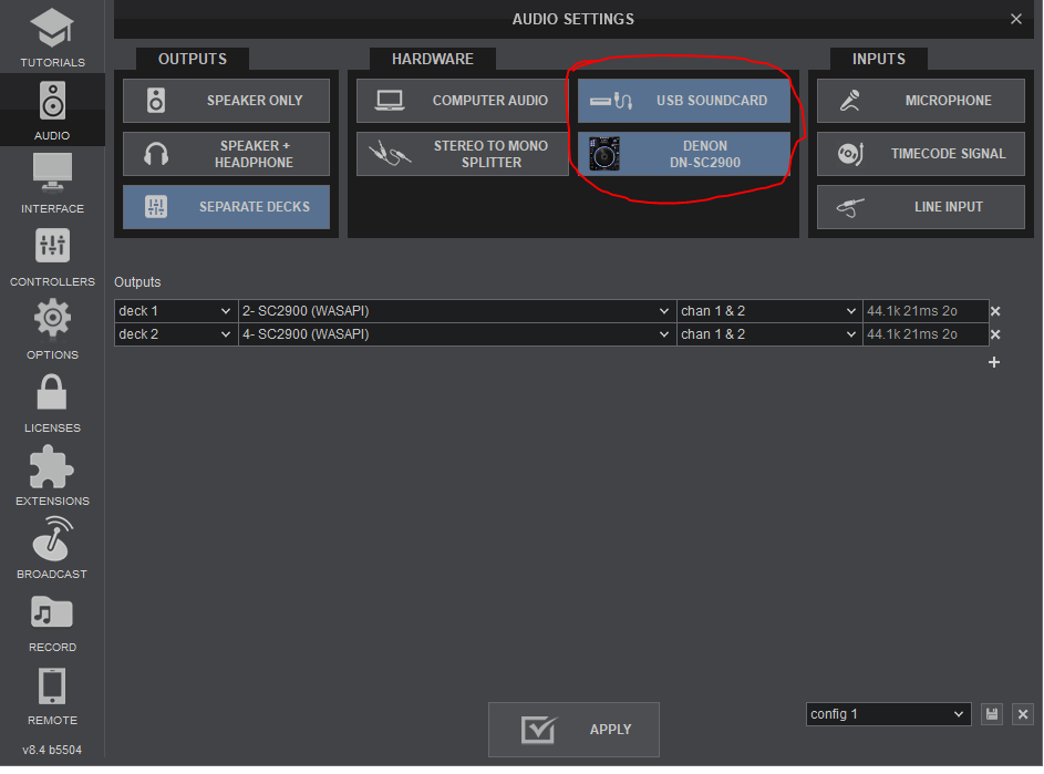

That's pretty weird.. without the ASIO driver installed, there doesn't seem to offer any WASAPI driver, so there is no ..
Audio device found: .... Denon device entry.
Therefor you shouldn't get any Denon entry in Windows Device Manager under "Audio inputs and outputs" either, right ?
This means that you have to install the Denon ASIO driver from Denon legacy downloads (https://www.denondj.com/downloads#legacy - scroll down to SC2900, ASIO driver 2.22)
After you install, there should be (hopefully) a button for Denon SC2900.
Please repeat the procedure above after installing the ASIO driver and provide the content of the Log Report.txt. Really curious to see if the WASAPI will be there now.

Hi Djdad,
Good news, I now have audio, via WASAPI, so all sorted; thank you very much for you help!
Ok latest log file below just for ref.
