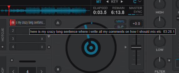

'its just on pads..
Shows the full text way for the hotcue dedicated area (see image)
(as well as on the cue markers on waveform,. as mentioned before.. )

Will be fixed in the next update for the pads as well :)

Hey Rune - you are a star for noticing that it's just on the PADS - Thanks! :) Now i can start using the new version ha ha!
And thanks Adion for saying this will be fixed in the next update.
