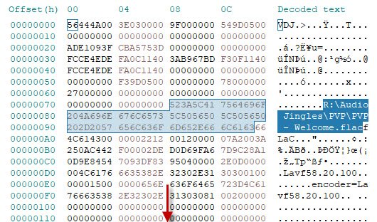

A healthy sample file with path intact created by dropping the audio file into the sample side panel:

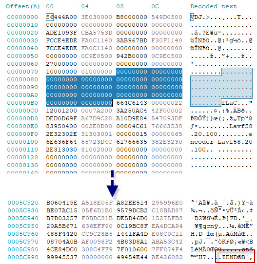

After changing the key mode (or setting/scanning for a key) - the path is now nulled, the length of the path area is even extended to some apparent arbitrary length, and path now exist at the end (where the thumb normally would be - in this case there is no thumb yet, see below):

What happens now is that the the path is removed completely and we see the end of the PNG IEND chunk (or last part of the PNG thumb) instead where the path was (seem to be offset/pointer assuming path is found at the same location as the thumb):

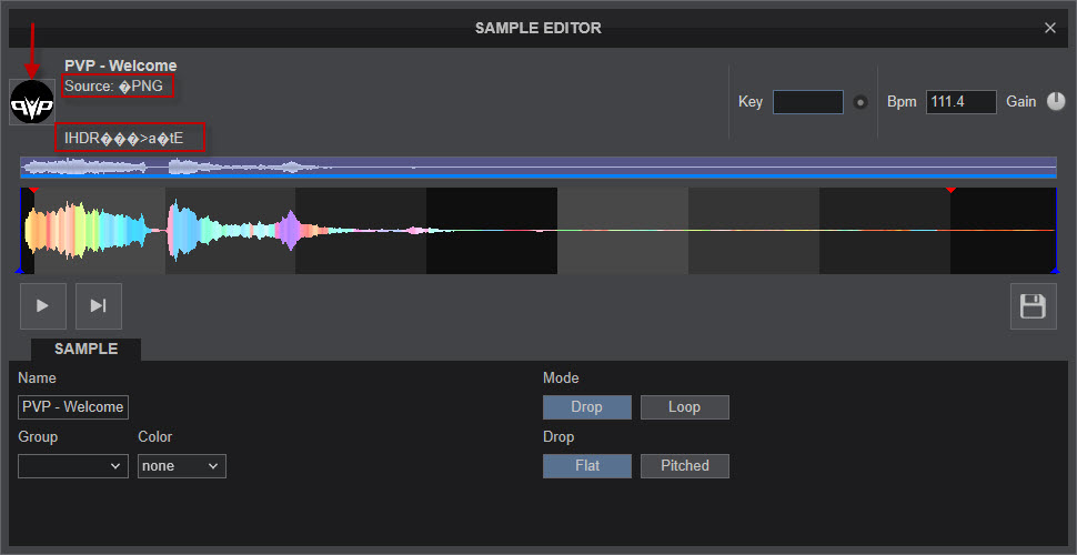

Also, in VDJ we'll now see the PNG IHDR chunk represents the path confirming this:

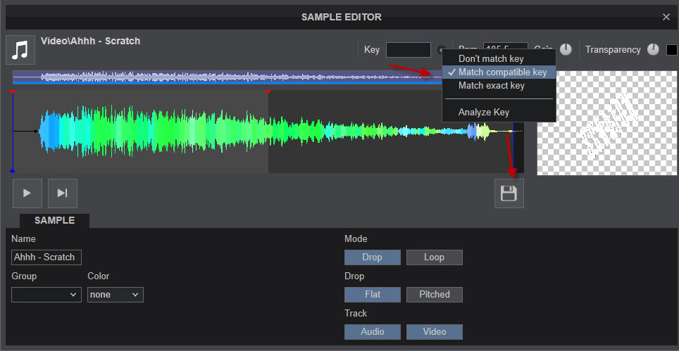

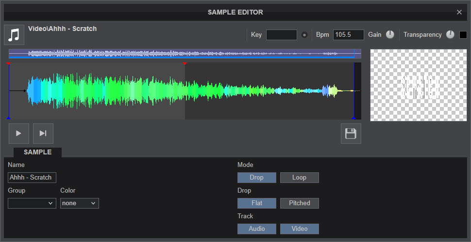

Related is for example Audio+Video samples where anything key related is changed.
Take the included sample as the Ahhh - Scratch.vdjsample:
Then change something with key:

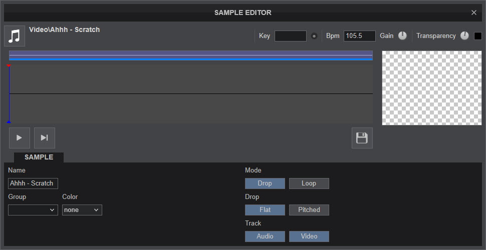

The sample is now mangled, data gone in display (but exists in the file) and cannot be played:

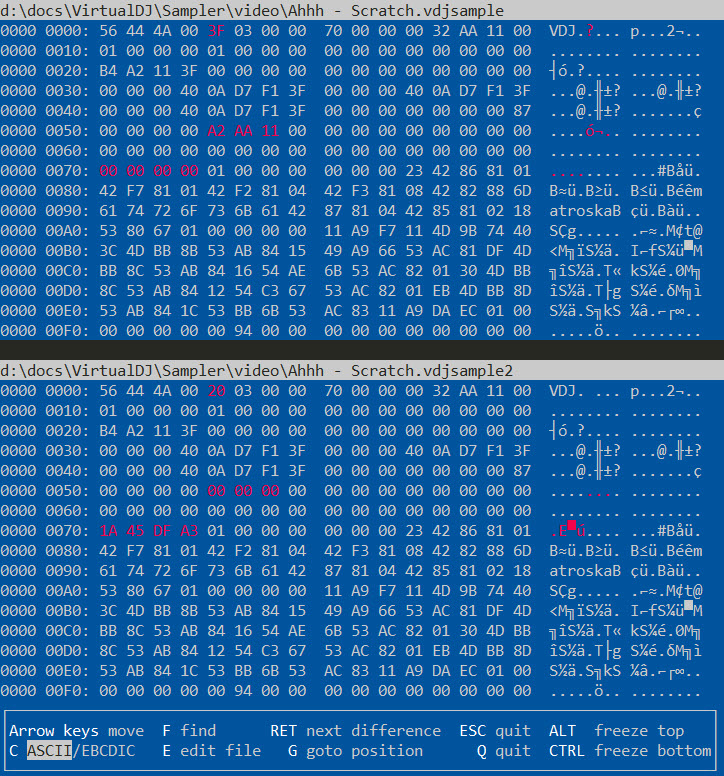

The only change seem to be related to transparency color(s) (?) and something early in the header. The "key" area (?) (0x70 - also see offset stored at 0x08) seem wiped as well. Diff between the mangled and original files:

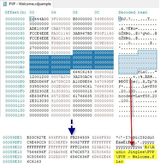

Ref. first post: Just noted - it seem to mix up the offsets that exists at 0x54 (Uint32 for thumb) and 0x5C (Uint32 for path). Hope this helps tracking down the bug.
In this image they are also the same pointing to the same data:

Not sure why it couldn't be reproduced. I made a short screen cast showing the steps below - it's essentially open the editor, set some key flags, save and boff :).
The system is Win 10-64, VDJ v.8.4-64 b5402 (I can't remember if this happened in earlier versions).
