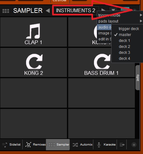

The small button in the sampler and choose master or channel output.

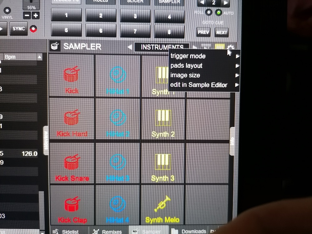

Hi,
Thanks for your reply, but this option isn't on vdj2020?
W
W

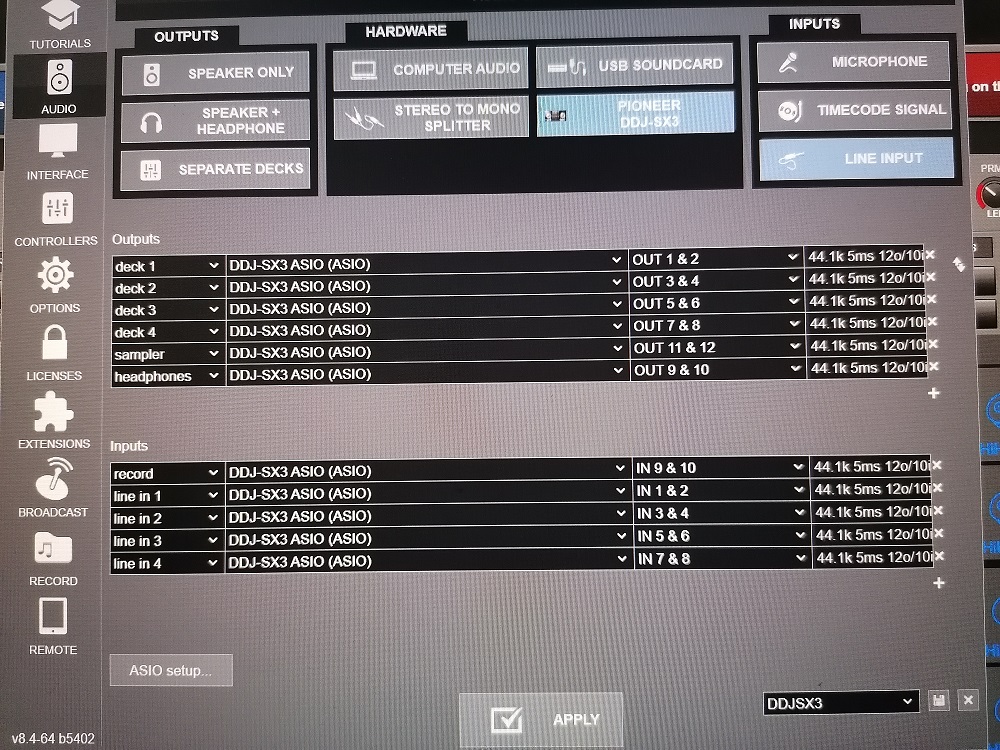

Yes it is. What's your audio config? Please post a screen grab.
It should be as shown in the SX3 Setup Guide...

Hi,
Here it is.
W

If you have a sampler output in your audio config, vdj will use that output for the sampler instead.
If you want the sampler on the deck output, you should remove the sampler output from the audio config.
But since it looks like the SX3 has a dedicated sampler output, it is probably better to check the SX3 manual on how to activate the sampler/change the volume.
