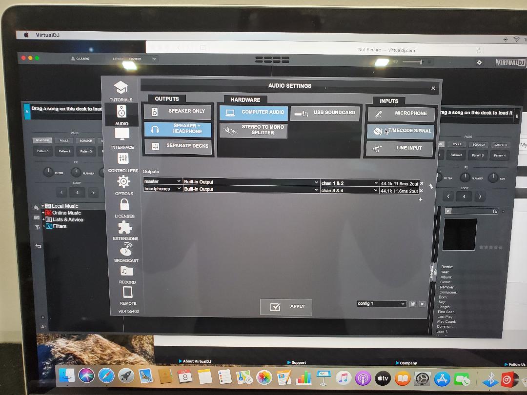

also when I try to install the audio settings it doesn't give no other option than BUILT-IN-OUTPUT. I can not select anything other than the default setting

ok thank you for that information. I was going crazy last night trying to figure this out. ok I bought that virtual dj infinity pro software, I have a pioneer ddi sz controller and when I try to configure the settings for the audio, it doesn't allow other options only BUILT IN OUTPUT. I have no other drop downs. I have a MacBook Pro

this is where I am having the trouble. it does not give me options to change the settings in the built in output.

VDJ is not showing a setup box for the SZ, so it looks like the drivers are not installed.

...or blocked
When MAC OS X blocks the drivers, VirtualDJ can't access them (and appears as if they are not installed)
Pioneer has made a very nice PDF file explaining that.

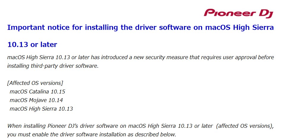

this is what am getting
Important notice for installing the driver on macOS Mojave 10.14 or macOS High Sierra 10.13
macOS Mojave 10.14 and macOS High Sierra 10.13 introduced a new security measure that requires user approval before installing third-party driver software.
When installing Pioneer DJʼs driver on macOS Mojave 10.14 or macOS High Sierra 10.13, you must enable the driver software installation as described below.
Note: This does not affect drivers that were already installed before updating your system to macOS Mojave 10.14 or macOS High Sierra 10.13.
1. If you install the driver for the first time after updating to macOS Mojave 10.14 or macOS
High Sierra 10.13
High Sierra 10.13

this is it a multi page PDF file
https://www.pioneerdj.com/-/media/pioneerdj/downloads/other/troubleshooting/troubleshooting_highsierra_or_later_e.pdf?la=en&hash=A0AF34B1097D63A83FE5DF7F1182F9F0A1EB4EC2
