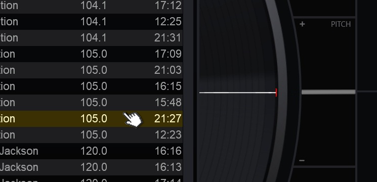

Hi guys I have a problem:
when I view the sidelist above the jog wheel I see the mouse cursor.
If I move the mouse wheel it scratches me.
How can I hide the scratch slider on the side list?
Thanks.
Zanard.
Thanks.
Zanard.

You need to use a condition on the panel that has the scratch disk and use two different mouse masks. One for when the sideview is not visible, and one for when it's visible.

Thanks George, but it is not clear to me.
I'll give you my example:
When I press the button the fileview opens above jog
From your example I should integrate in the panel 'list' the variable <scratch visibility = "var_equal 'BrowserOver' 1"> to turn off the mouse?

Yes, I need the actual action(s) of the button(s) in order to help you more.
Obviously the button has an action that makes the song list to appear. I need to see that action in order to tell you how to modify it so that in conjunction with the code I gave you for scratch elements it fixes the problem

<button action="skin_pannel 'list' on">
<size width="132" height="21"/>
<pos x="820" y="1405"/>
<text size="20" weight="bold"color="#5F5F61" align="CENTER" format="SONG LIST"/>
<textselected weight="bold"size="20" align="CENTER" color="#9D9E9E" format="SONG LIST"/>
<textover weight="bold"size="20" align="CENTER" color="#9D9E9E" format="SONG LIST"/>
<button/>
<panel id="list" group="master" visible="no" >
<square border="5" border_color="#222328" radius="10">
<size width="1412" height="1481"/>
<pos x="-625" y="100"/>
<gradient x="" y="" type="vertical" color1="#090A0C" color2="#00000"/>
</square>
<fileview>
<size width="775" height="1465"/>
<pos x="1" y="110"/>
<colors background="#070707">
<toolbars background="#171717" text="#9D9E9E" iconbackground="black" border="#222328" />
<lists background="black" stripes="#1E1D20" over="#3B3003" overstripes="#3B3003" selected="#4D3F08" focus="#8A7213" text="#9D9E9E" overtext="#FCF6C2" selectedtext="white" focustext="white" automix="#2E2E2E"/>
<grids background="#171717" over="#3B3003" selected="#4D3F08" focus="#8A7213" text="#FCF6C2" overtext="#FCF6C2" selectedtext="#FCF6C2" focustext="white" stripes="#2E2E2E" overstripes="#3B3003" selectedstripes="#4D3F08" focusstripes="#4D3F08" label="white" />
<columns background="#222328" text="#B2B3B3" />
<scrollbars background="#222328" button="white" />
</colors>
<font size="20" name="" />
<fontheader size="20" />
<fontgridtitle size="20" />
</fileview>
</panel>
Posted Mon 02 Dec 19 @ 6:38 pm
<button action="toggle '$BrowserOver' & var_equal '$BrowserOver' 1 ? skin_pannel 'list' on : skin_pannel 'list' off">

If I did it right, it doesn't work..
<pos x="820" y="1375"/>
<text size="20" weight="bold"color="#5F5F61" align="CENTER" format="MASTER MIXER"/>
<textselected weight="bold"size="20" align="CENTER" color="#9D9E9E" format="MASTER MIXER"/>
<textover weight="bold"size="20" align="CENTER" color="#9D9E9E" format="MASTER MIXER"/>
</button>
<scratch visibility = "var_equal '$BrowserOver' 0" deck="left">
<size width="935" height="1223"/>
<pos x="3" y="100"/>
<mousemask x="358" y="3790+161"/>
</scratch>
<scratch visibility = "var_equal '$BrowserOver' 1" deck="left">
</scratch>
</square>
<fileview>
</colors>
</fileview>
</panel>

Thanks George works perfectly!
Fabio.
