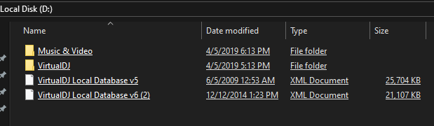

This is what's on that drive.
There are also databases in folders VirtualDJ and the renamed VirtualDJ2. Which one do you want me to send, and where?
Posted Wed 04 Dec 19 @ 9:58 am

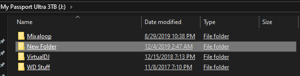

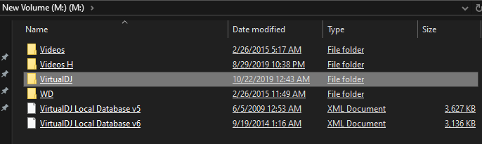

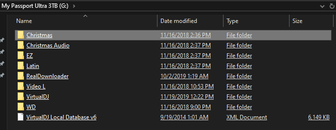

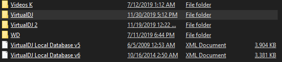

I just noticed that this is what my other drives look like.
Each one has a database inside the VirtualDJ folder. As you can see, some have V5 and V6 databases. Are all of theses needed?
Posted Wed 04 Dec 19 @ 10:27 am
