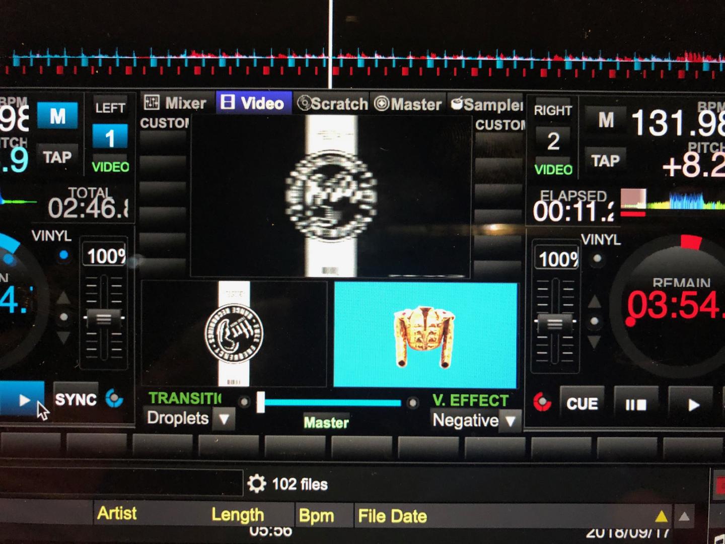

Hi
Thanks for the message , the skin is ace apart from this issue , have put an image below where you can see the crossfader just above the word Master. This crossfader only mixes Video and not Audio hence the issue.
Hopefully you can see what I mean now, also the master video output is blurry , I'm sure I have got on some sort of post video effect but can't seem to find where this is or how to turn it off.
thanks in advance for any help you can give me
chris

In "2 decks mode" and on video tab, there's only the "space" for video cross fader. It's by design, not an issue.
If you want to see audio cross fader in the video tab, you must switch to "4 decks mode".
Posted Wed 20 Nov 19 @ 2:33 pm
Ok Thanks for the reply , I have found it in 4 deck mode so can work with that although as a future update if it could somehow be added to the 2 deck that would be a nice touch.
