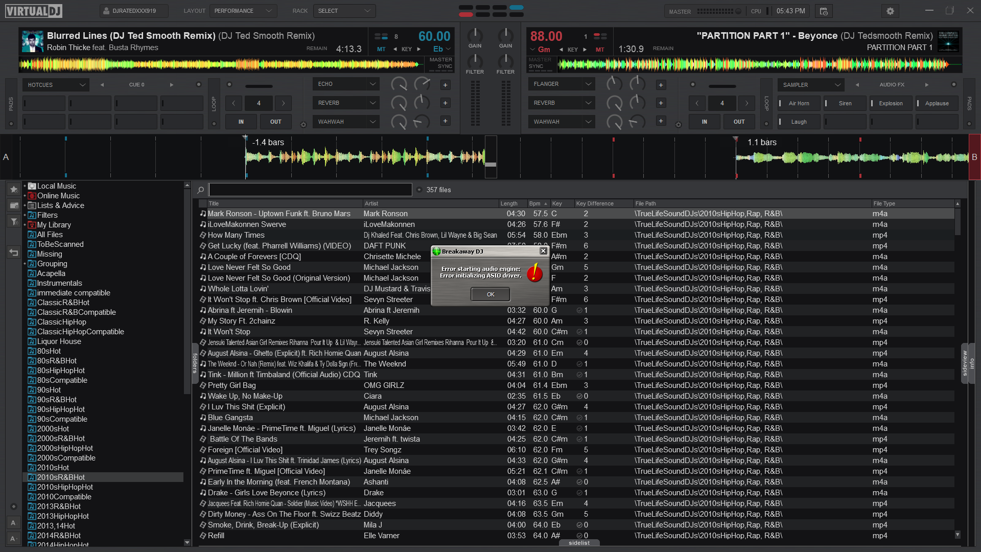

I'm borking it up lol...how bout I send it to you and you add this last part.
Starter
Essentials
Pro
Performance
Performance Pro
Is how I'm trying to have the menu.
Starter
Essentials
Pro
Performance
Performance Pro

No. When I mad those changes. I did see performance pro but it replaced performance instead of adding. Also it would have check marks on performance pro and pro. So I just went back to the initial drop down without performance pro.
Posted Sun 10 Nov 19 @ 5:12 am
