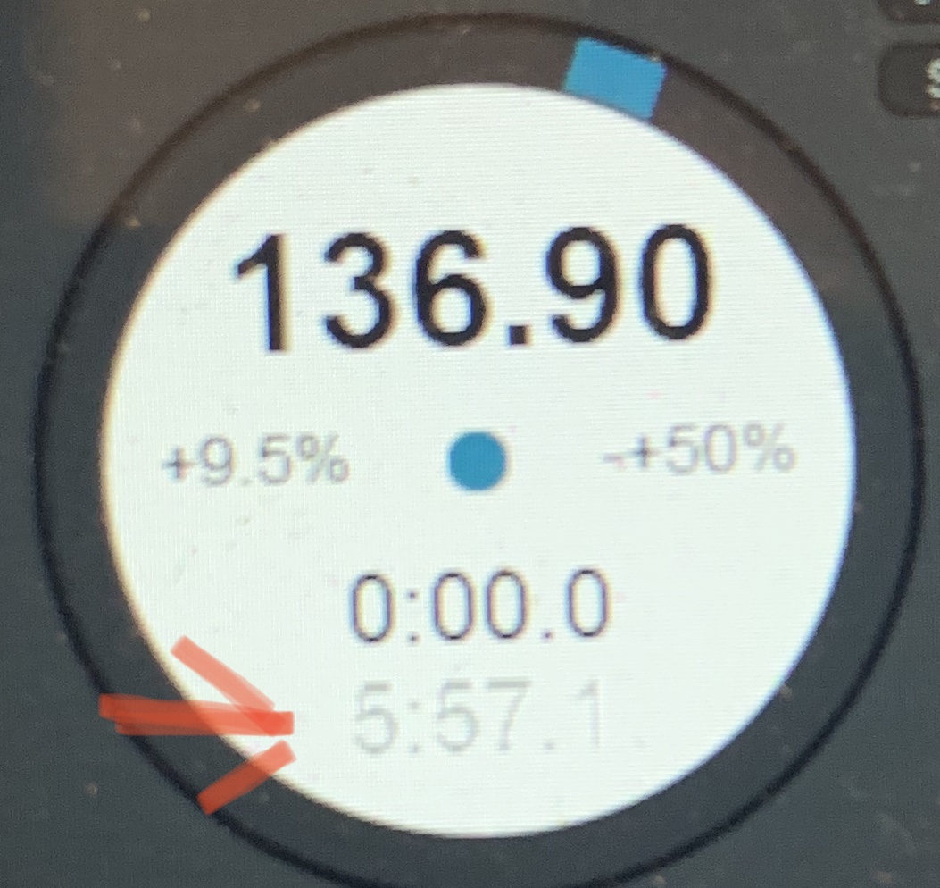

Okay I think I’ve worked some of it out
I have to use the define colour =textdark1
And change the name of the define so copied it created a new one So above is what I’ve called it .
then go to the elements text zone and change it there to .Otherwise if I use the same define it will mess up other areas that The same info on a black background Correct. ?
There’s just one I can’t find see red arrow in image

I could give you 5 minutes and you'd find it, but what are you looking at? [think a second] remaining time. looks like [b type] 1191 to me [action="get_time 'remain' is the hint].
A hint perhaps you being old school [I'm no skinner just a bodge artist with time], skins don't need to be zipped any more, and you can make a change, save and then reload the skin [by selecting it from the drop down]
the poke it and see way of doing things is much easier these days, because it's poke the xml, save, alt+tab into vdj, refresh the skin [can be done with script] and you can see what happened.
*edit 1255 for c type jog [needle + text] for remain
*edit edit* may as well do these too, if bold clarity is the goal

The number you gave 1255 what size
So on my end it was 1256 so change that to but didn’t see a change . However when I switch to needle plus text realise I will need to do all of them text zonea as well ?

dyslexia with motivation is no handicap, might take a long warm up, but the time trying to teach it to yourself, [poke and figure] you start seeing between the lines.
[ I can't code for shit now & my second ever plugin has had top spot for audiofx for 3+ years]
About the text, you're right, there's 3 types of jogwheel in the pro skin
a type [not called a type but it's the no text variation]
b type [just text]
c type [text & needle]
change any b&c type textzones color to black,
the lines I've given you is there abouts where to look
"black" & "white" are defined for each colour scheme [for daylight "black" is defined as #FFFFFF (white), "white' is #000000 (black) ]

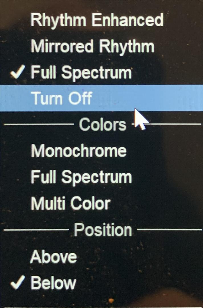

Okay guys I managed to sort it all out and got the downs working out they need to be again thank you so much for your help .
I want to learn the new skin engine as I want to stay involved with the software and the community . And maybe one day to the level that I can help people like yourself
So onto the next question I will use this topic for all of my questions and things I want to change maybe people can also use this for reference.
Hope my dictation is working well and you can understand everything that is being written as I use my iPhone to dictate in this forum.
Okay I have managed to insert turn off into the rhythm waveform panel Okay I have managed to insert turn off into the rhythm waveform panel. Drop down box . I would like to be able to turn this off We currently have three options . And when I drop the box down now I see the three options and also turn off what would be the code to make this happen if possible . I’ve been experimenting with no success . As don’t really understand the new panel system at this .100% I know how to make panels but not make them disappear . I would still like the option to have it but also the option to turn it off . So so far this is what I have .
Obviously at the moment it’s just a piece of text in the drop-down with all the other options . What would I need to do to actually make this turn off if possible or am I wasting my time . If anyone can help would be very much appreciated .

A few sections to this, hopefully someone who is proficient with skinning will reply but I'll start the ball rolling
Not sure this is the best way so, maybe hang fire
first you've added your wave option into
1474 <submenu text="Waveform Display" localize="true">
it might be easier to treat it as a waveposition instead [as wave display is a setting, waveposition is based on a variable]
1482 <separator text="Position" localize="true"/>
add this just under, [sets var '@$waveformpos' to 2, as this var is used for panel position logic]
<item text="Off" localize="true" action="set '@$waveformpos' 2 & load_skin" check="var_equal '@$waveformpos' 2"/>
right then when the waves are positioned below, the decks, mixer are in the right place, the wave needs removing and the browser needs to be resized and repositioned.
first we need to tell the decks where to be with this new variable value
left deck first [around line 1850 <define class="deckleft" ]
so we have this at line
1852 <pos x="0" y="+43" condition="var_equal '@$waveformpos' 1"/>
change to
<pos x="0" y="+43" condition="var_not_equal '@$waveformpos' 0"/>
same thing needed for right deck [ 2722 <define class="deckright" ]
at
2723 <pos x="1920-799" y="+43" condition="var_equal '@$waveformpos' 1"/>
change to
<pos x="1920-799" y="+43" condition="var_not_equal '@$waveformpos' 0"/>
right I think that's the decks happy, next is the wave [called topwave panel]
at this line, it starts the code for the wave, and we only need this if the var is not set to 2
4216 <panel name="topwave">
change to
<panel name="topwave" condition="var_not_equal '@$waveformpos' 2">
that's the waves done !
mixer next, around 4677 you have the positioning
<panel name="mixer" width="1920-799-799" height="341">
<pos x="799" y="44+173" condition="var_not_equal '@$waveformpos' 1"/>
<pos x="799" y="43" condition="var_equal '@$waveformpos' 1" />
change to
<pos x="799" y="44+173" condition="var_equal '@$waveformpos' 0"/>
<pos x="799" y="43" condition="var_not_equal '@$waveformpos' 0" />
That should be the mixer happy, finally the browser around 5808, but I wait on that as just looking at it makes me want a coffee.
*edit, just tested, so I removed the part about the waves where I doubted myself as it works
change to
at
change to
change to
change to
