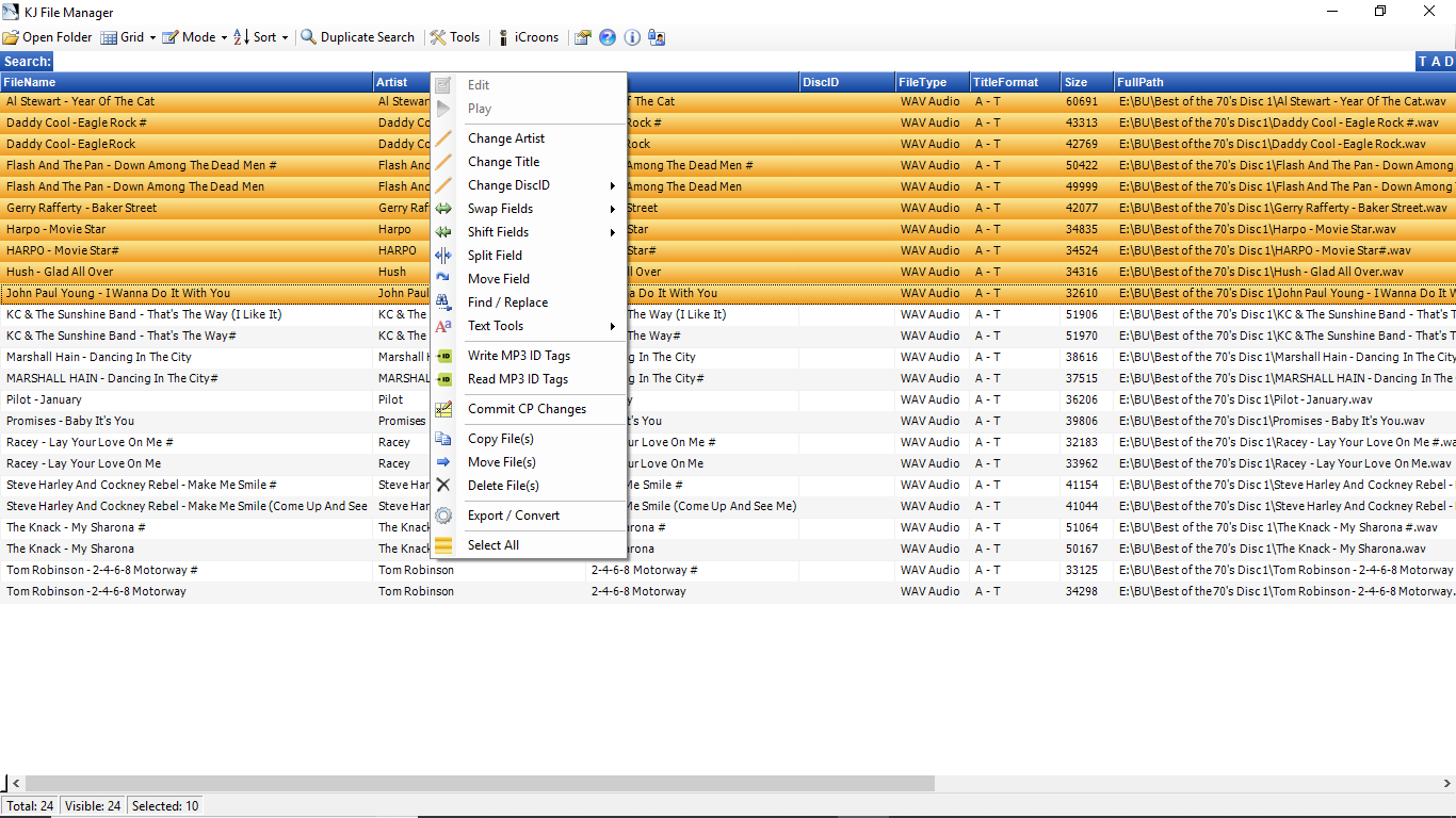

Thanks, I,m using KJ file manager.

KJ File Manager is made by Karaosoft, BTW. He makes other Karaoke programs too which I have used for years.
Ok, Couple of things it will do that I think VDJ can't:
1. Batch swap fields. For example if the file has the artist and title back to front, you can select how ever many of the files that have this condition and swap fields. Doing so will also amend the file name. So you import the folder as "title"- "artist" ,swap fields, export as "artist" - "title". Very easy.
2. Usually with compilation albums the files are all wrong, meta data is all wrong, because they have not been named properly by the label. So import in what ever format is closest. Make batch edits and field swaps till all data fields and file name is correct. Then you can write data tags with discogs lookup in one click. Then export in desired format with correct data.

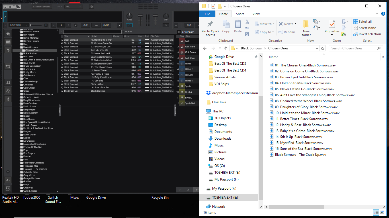

I seem to have a lot of albums that come into VDJ with the track number and title together.
Is there a reasonably simple way to avoid this? Or a way to have VDJ ignore the track number, only using the Artist & Title?
See pic.
See pic.

What's the source of those tracks? Did you rip them? Were they downloaded from a retailer?
Personally, I always run my downloads through Tag&Rename first, before importing to VDJ.
Remember, VDJ is DJ software, not dedicated tag editing software. It may be able to do a little tagging, but it won't be as versatile as the real thing.
Lots of people are happy to use their phones to take pictures or video, but phones are not as good at it as a dedicated DSLR or camcorder...

Kenny Speed wrote :
For these situations I use two software in combination (provided that both filename and tag contains the track number):I seem to have a lot of albums that come into VDJ with the track number and title together.
- Advanced Renamer (free for personal use) https://advancedrenamer.com/
- Mp3Tag (free, and handles mp3, flac etc.) https://www.mp3tag.de/en/
Then:
- Use AR to set up renaming rules to remove the number prefix (truncate or use custom script, whatever you're comfortable with).
- Finally run the files through mp3tag to generate tag from filename. The latter can in this case also be done by VDJ using the tags from filename function in the tag editor (small button between the artist/remixer sections). Works with batches as well.
Posted Fri 25 Oct 19 @ 7:31 pm
