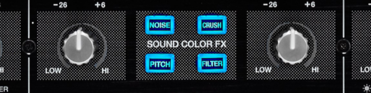

Ok so there’s 4 buttons as you can see from the picture.
When I press filter and turn the color knob I can control the hi/low pass
Now let’s say I press the Noise button while the filter is on.
It’ll shut off the filter and now when I turn the color knob it controls the Noise.
All’s I’m trying to get is the button that says crush to activate or turn on VDJ’s color cut fx and be able to control it via the color knob.
None of these buttons or knobs are touch sensitive.
Posted Mon 16 Sep 19 @ 12:39 am
