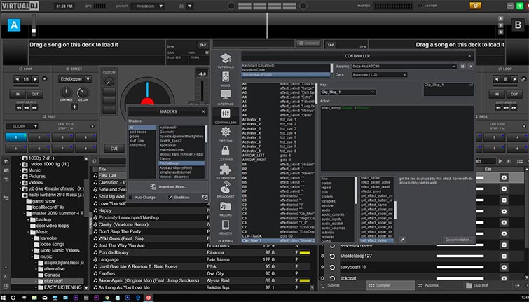

i tried to link the shader to the apc 80 and put selected shaders on single buttons but for some reason its not working ,. get_effect_string "shader" 2 "Echo"
now that we have custom pages its even more confusing. maybe its been a long day..
shader page is groovy and sample is geometry . can we do this for all the pages?

it opens shader but does not select the shader geometry
Posted Wed 11 Sep 19 @ 2:08 am
ok , i still haven't had this work.
lets say the folder is "stuff i like"
i have "Promethean"
and im trying to select that shader only what did i mess up
My action didnt work as i thought . nothing happend.
im lost.
i have "Promethean"
im lost.

effect_string 'shader' 2 'geometry'
works here, you'll need b5402 or greater.

that's what i have is 8.4 b5402 .

Ah right, sorry I've already done this one before, I work with shaders on decks, I'm guessing you're using the AOV? [audioOnlyVisual]

my question stands are you using shaders on decks? or shaders on deck master as a video fx? or as an audioOnlyVisualisation?
where matters.

im trying to use it on master decks . i just wanted to have different shaders linked to buttons on my apc 120 that has 120 buttons. so its just push a favorite shader and it plays as i like . I just let it play in the back ground as im doing my thing .

I'm guessing you're using the AOV slot then
effect_string "audioonlyvisualisation" 2 "geometry"
with that may buttons to play with you could do so much more video than just pick a shader
This was just 8 buttons and the videoCrossfader was automated with zVideo padpage
