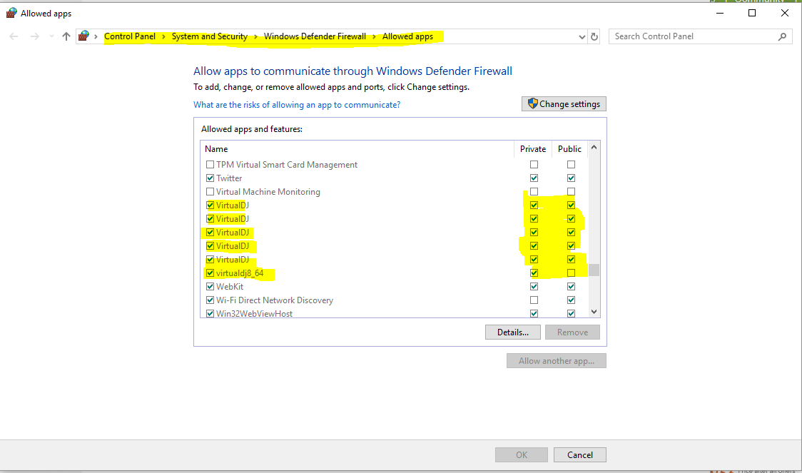

I used to get same message.
VirtualDJ needs to be made exception in firewall:
after doing this I had no issues connecting
