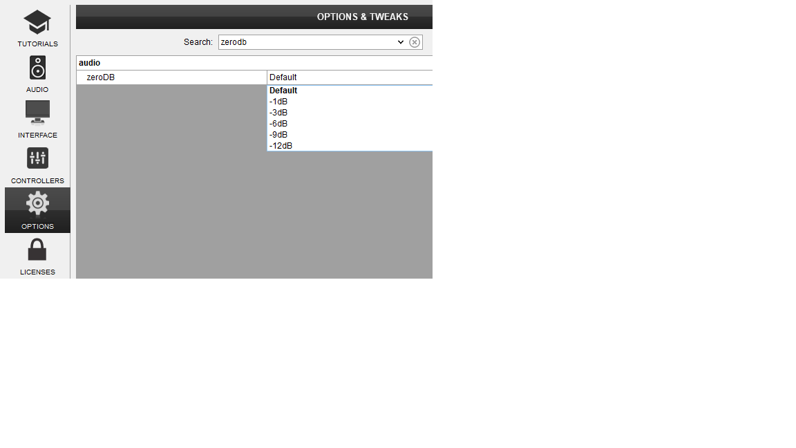

Go to Settings, Options and type in zerodb to change the Master Volume Output. I like going for -12dB for recording at home and I use a headphone amp to crank the volume up for my headphones. Other people use -1, -3, or -6dB.
It's also useful when playing in a venue where they have a limiter/gate/compressor and you don't want to run into their limiter.

Any ideas about volumes and gains settings on the controller for recording?
When I'm done with the recording, do I change the master volume back to default, if so how is it done?

Yes, I manually put my zeroDB back to the default after I'm done recording. OR
