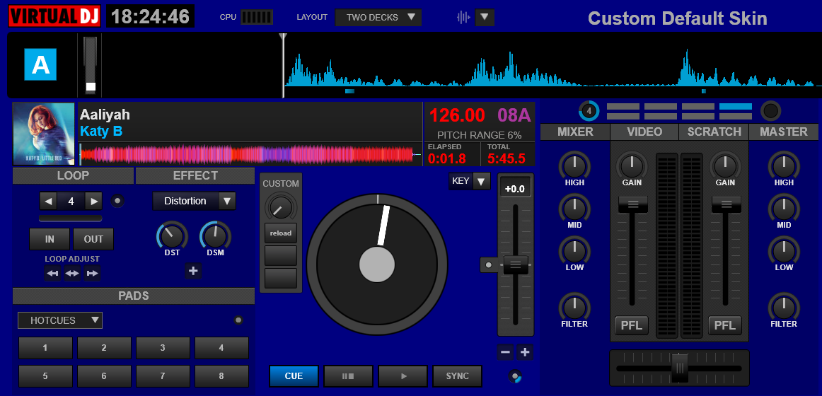

From the skin SDK...
center="" : Provide the X position of the center of the wave. Helpful if you need to create an off-center rhtyhmzone (sic)
Tada!
The rhythmwave stays where it is. You just specify center (in the above image, center="400"), then the X position of the overlay (the white line) has to also be moved.
Tada!
Posted Thu 08 Aug 19 @ 5:08 pm
Thanks, that one slipped me by, what line did you edit for that?
Posted Sat 10 Aug 19 @ 8:34 am
For example, with the following panel:
.......you need to add center="your choice of X location" to the <rhythmzone> line, which will shift the whole wave across. Then for the white line, change the pos x= in the <overlay> section at the bottom.
Bear in mind that the PNG has a white line drawn in the centre on the rhythmwave background, so you could either erase it or overlay it with a <square> visual instead (as I've done in the pictured example).
Also, if you use the 'extragridlines' option in the skin, those need to be shifted across to match.

Thanks for the info, unfortunately it looks like scratchwave has no center param.
Posted Sat 10 Aug 19 @ 9:10 am
That's an issue that needs to be addressed then, as if a user/skinner decides to implement an off-centre rhythmzone, the wave choices will all be off-centre apart from the scratchwave.
Posted Sat 10 Aug 19 @ 9:15 am
As of build 5269 - waveformCenter config option added, works for default and scratch waves.
It takes a little time to retrain yourself but it's a great addition.
Posted Fri 06 Sep 19 @ 10:49 pm
