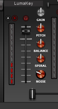

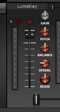

Trying to map sliders independently of each other (Pitch, Balance, Spiral, Noise) to the controller's 4 discrete knobs. I keep seeing ghosting of other three knobs and am wondering if this is a bug or user error?
For example, if I use knob 1 on the controller, the skin correctly shows the knob moving, but also shows the "ghost" of the other three knobs (as shown in image).
The code:
(Knob 1)
deck 1 effect_slider 'Pitch' 1
(Knob 2)
deck 1 effect_slider 'Balance' 1
(Knob 3)
deck 1 effect_slider 'Spiral' 1
(Knob 4)
deck 1 effect_slider 'Noise' 1
The code:
(Knob 1)
(Knob 2)
(Knob 3)
(Knob 4)

I understand all of what you are saying. The problem is that If I move one knob on the controller for a specific effect, the knob on the software end shows the proper movement, along with the ghosting movement of the other knobs.
If I control the knobs using just the software, all visuals works as intended.

All controllers... anytime I map the knobs, it's the same result. Mind you, if I use the effect slot, the ghosting functions as expected. But I'm looking for a single effect to map, not a slot.
