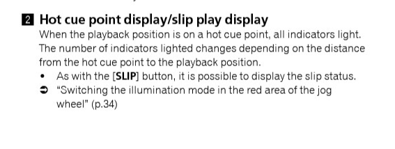

Are you talking about the 4 red inner quadrant lines ? Its just 4 to be accurate on the song position. Are you sure its how they work in Serato ?
This is part of the Pioneer Manual..
Anyways, about what you asked for, you can try :
LED_JOG_INNER to map as .. song_pos
