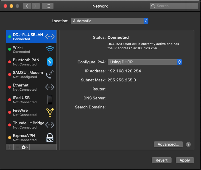

DDJ-RZX USBLAN is showing as active and connected.
I am not getting the DDJ-RZX screens plugin to work at all. I have tried uninstalling the plug-in, restarting mac, re-installing plug in, restarting mac to no avail.

Sorry, quickly to add, RZX functions correctly when using Rekordbox and all screens function as they should so can not be a network issue.
