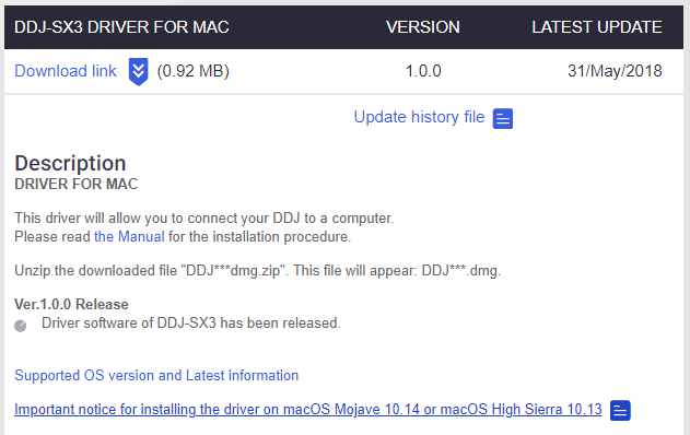

Since you are on MAC, you need to make sure that you allow Pioneer drivers to execute (see important notice on PioneerDJ wesite)
https://www.pioneerdj.com/-/media/pioneerdj/downloads/other/troubleshooting/troubleshooting_highsierra_003_e.pdf
