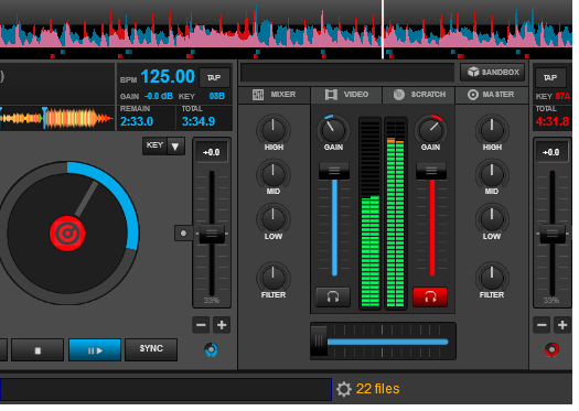

Por favor, algo tan simple y fundamental, pongan el VU en escala de verde a rojo. / Please, something so simple and fundamental, put the VU on a scale from green to red.

There are many skins which have traditional VU meter colouring.
Another thing to bear in mind is that the internal VDJ audio signal is digital, therefore it's always "green" (because the maximum signal is 0dB). VDJ has a limiter which prevents the signal causing overload & distortion.
Posted Sat 25 May 19 @ 9:15 am
I mean, inside Deck A, B, etc. Not the main output volumen. I need it for each song to avoid seeing my controler or my DSP rack system. I requested for the main and default skin. Because normally when you use a third party skin, something does not work.
Absolutely not true. I have a large selection of skins and use those far more than the default, without any issues.
As long as you download skins from here, they should cause no problems.
Posted Sat 25 May 19 @ 4:48 pm
This was lost in translation and not as clear as it meant to be...
The original petition is about having the official VirtualDJ skin with Gren to Red VUs for each deck, and not only the master volume (ie: Green from -20 to -6, Yellow from -5 to 0 and RED from +1 to +6dB). There are customs skins that may have this option and work fine, but DJ Kozz the sugestion is to have this option in the default VirtualDJ skins.
Recording VUs should asve this too.
