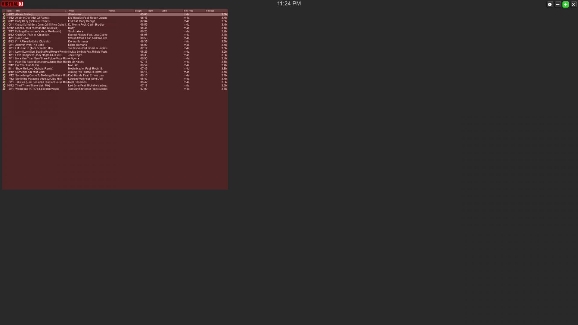

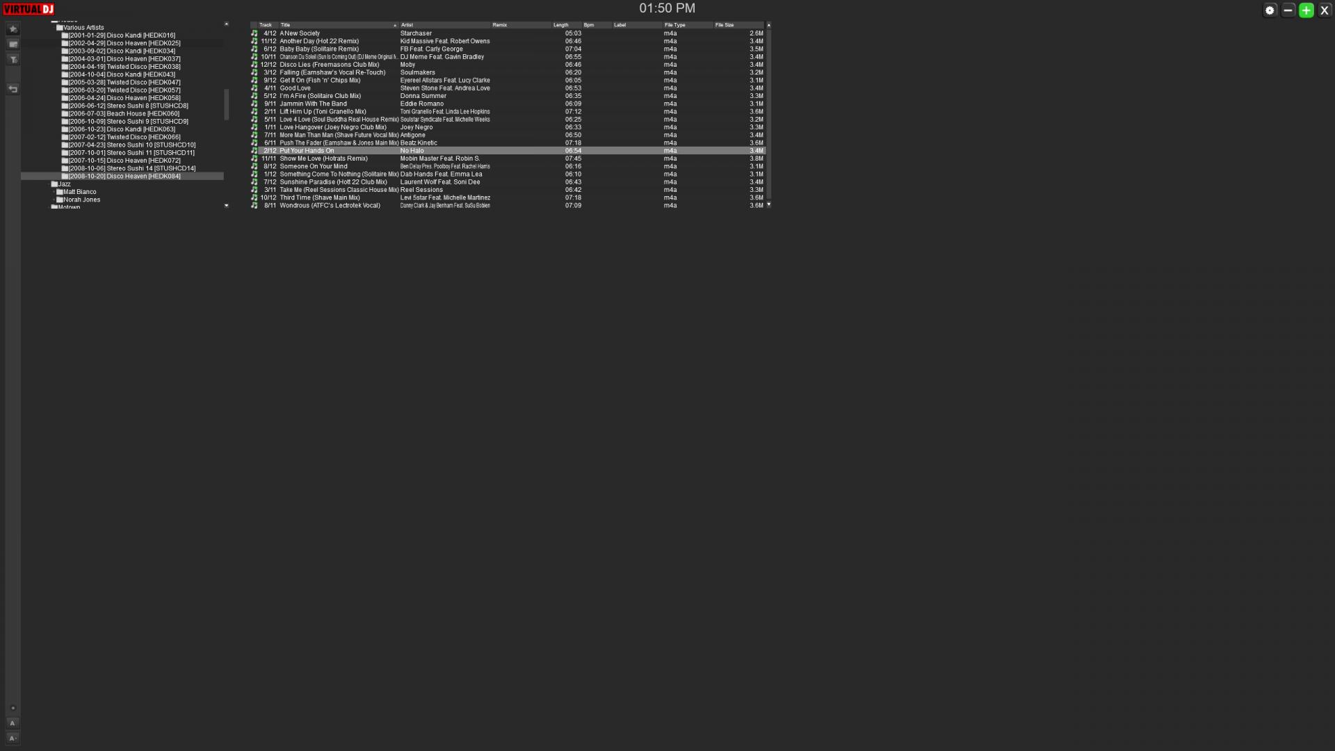

Here is a screen grab of the result and the <filelist> area should be at least twice that height.
I have loaded the capture into Affinity Designer and create a highlight in red of the area that <filelist> should of filled
I then resized the highlight area to match roughly the size of the area in the capture and it's height is 360px which is where I said it was going wrong for me.
Posted Sun 05 May 19 @ 10:27 pm

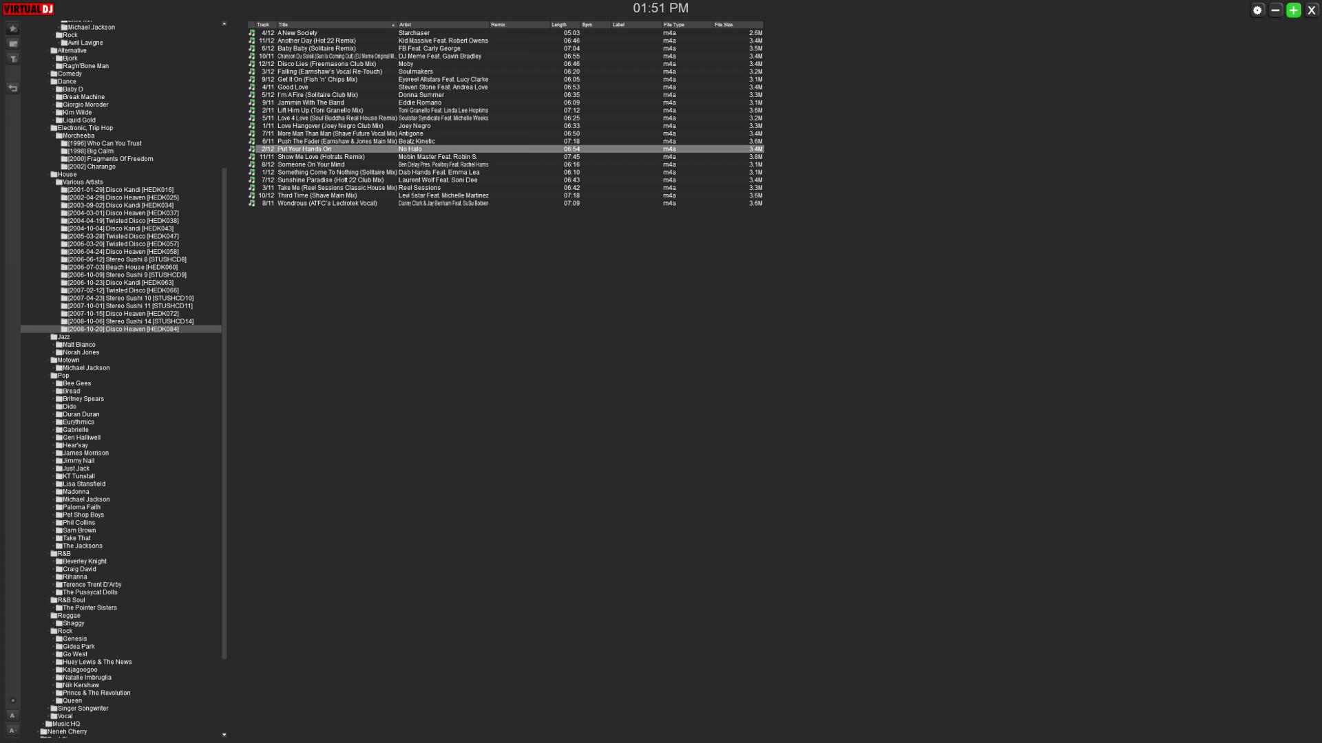

I have added your breakline to like this
<skin comment="Testing" image="test.png" width ="2560" height="1440" version="8" author="David George" name="Testing" nbdecks="2" breakline="42">
If I change my test area to
Test Area
<browsertoolbartree>
<size width="30" height="360"/>
<pos x="10" y="40"/>
</browsertoolbartree>
<folderlist>
<size width="400" height="360"/>
<pos x="40" y="40"/>
</folderlist>
<filelist>
<size width="1000" height="360"/>
<pos x="480" y="40"/>
</filelist>
I get this result.
If I change it to
Test Area
<size width="30" height="1390"/>
<folderlist>
</folderlist>
<filelist>
</filelist>
The height of the browsertoolbartree changes like this
If i then change it to
Test Area
<folderlist>
<size width="400" height="1390"/>
</folderlist>
<filelist>
</filelist>
The height of the folderlist gets bigger too like this.
Test Area
<folderlist>
</folderlist>
<filelist>
<size width="1000" height="1390"/>
</filelist>
then the height of the filelist should be the same as the other elements but it hasn't changed and here is the result.
Yes i may need to use splitpanel but when the individual elements aren't working properly yet then it's of no use to me at the moment.
Test Area
<folderlist>
</folderlist>
<filelist>
</filelist>
I get this result.
If I change it to
Test Area
<folderlist>
</folderlist>
<filelist>
</filelist>
Test Area
<folderlist>
</folderlist>
<filelist>
</filelist>
Test Area
<folderlist>
</folderlist>
<filelist>
</filelist>
