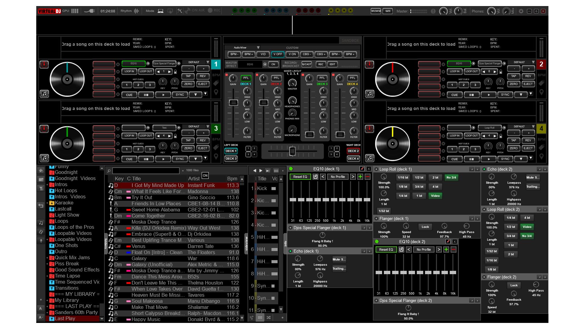

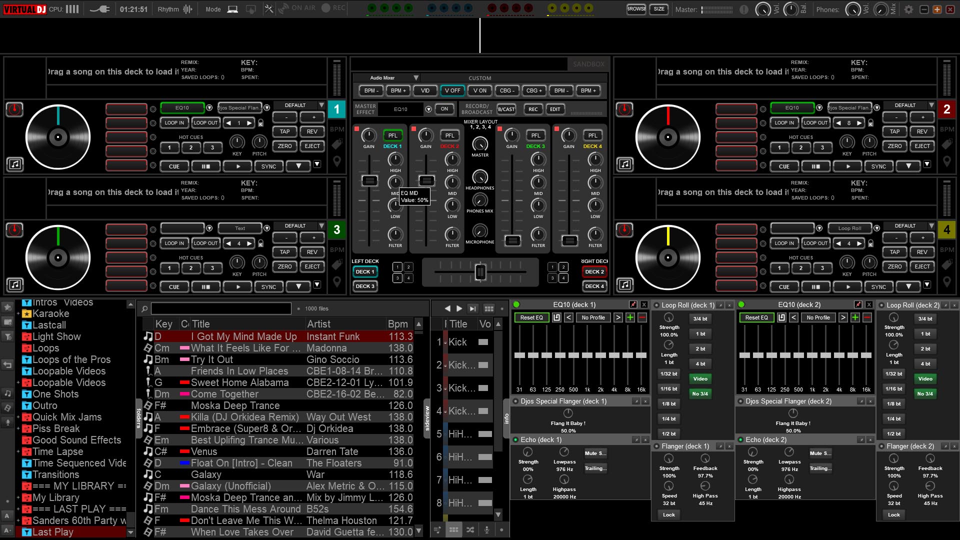

Thank you. Well I'm pretty much restored except for one annoyance. My EFFECTs line up perfectly when I'm at FULL screen. When I go to Window movable mode the EFFECTs go out of order. This is a NEW problem. I'll search for a SCALER
MAX SCREEN PROPER ORDER.
WINDOWED SCREEN OUT OF ORDER
When I launch in full window mode the order is correct. I'll go to movable window mode and it scales down properly. But if I leave it in movable window mode and re-start, the effects come up scrambled. I'm having no luck finding a "scaler"

The effect panels in the browser are automatically ordered based on available space, so as you resize the skin, the browser may get more vertical space, and panels might be rearranged. This is also the same and didn't change in any recent update though.

If I open in full screen all is well. I can click to a moving window and all scales down perfectly. But if I leave it like that and restart, the EQ10 screws up the effects section as shown above.

I found the work around for the unwanted re-arrangement in my effects section. I just select master EQ10 and it will pop up in the effects area compressing the arrangement. Then hiding the master EQ10 will make the effects go back into proper alignment.

If I close my session out in movable window mode, and re-start VDJ, it comes up in scrambled mode. If I close VDJ with full screen and re-start, it comes up in full screen, and all is good.
It's a "scaling" problem. Never had a problem until the new resident EQ10 was added. Can we get a fix for this?

So the temporary fix do a re-alignment is done by popping up the master EQ-10 and then hide it again. I'm much happier now.
