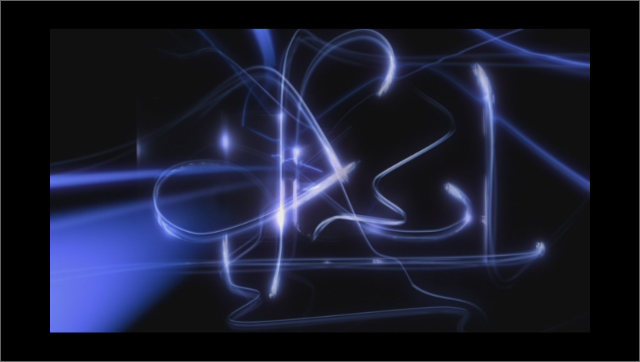

VDJ displays the video as intended, but when a plugin calls DrawDeck and then returns S_OK, the video shrinks. This is an example of a 720x480 with a display aspect ratio of 16:9.

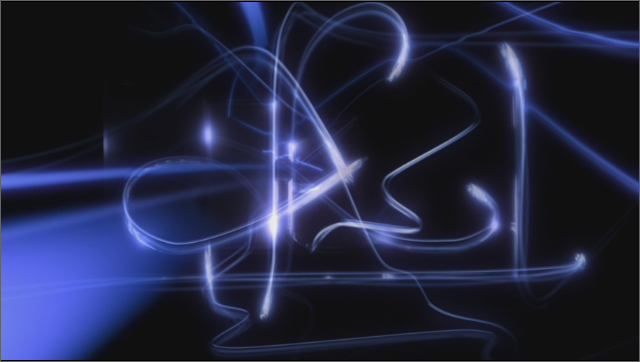

This is how it should look and the way it looks when no plugin is running that calls DrawDeck:
This is what happens when any video plugin calls DrawDeck and returns S_OK: (the video display has decreased in size)

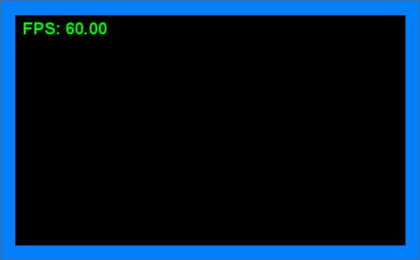

First with none of the new flags. This is using a low resolution video (260x40) to exaggerate so the problem can be seen easier.
This is TellyVisuals displaying a blue border the size of the display area on deck 1. There is no video playing on the deck so there is no problem. The FPS is a constant 60.

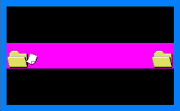

This is what happens when I put the low res video on deck 1. TV has been given the 260x40 resolution of the video to display in. This effects all video plugins. Then that 260x40 area is scaled to fit the display. The new video flags change this behavior but I am showing how it is without the flags in this post. The blue border now only displays in the area given by the video. Not the actual display size. Imagine how distorted text and everything else is going to be. This size is also going to be changing for every video of different resolutions which just adds to the problem and would be make you look like a complete fool.

Now with the same scenario as above with the low res video on deck 1 and TV displaying it's border using the new flag VDJFLAG_VIDEO_OUTPUTRESOLUTION.
You can see that the TV display is no longer distorted to death. But you can see that FPS has dropped to 10 which is no good but the display is much better and how it should have always been. In this case I am letting TV display the video texture in the background so the panel border is covering over the video. The FPS will go back to 60 when the video is either paused or stopped. So this constantly changing FPS is bad and still makes decks bad for something like TV.
This image is same as above except now instead of the displaying the video image as part of TV's background, I am letting the panel display it so it fits within the bordered area and no longer covered up by it.

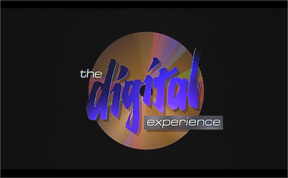

Now what about the special aspect ratio problem. Neither of the new flags give me anymore control of that. I don't want VDJ to display it. I want to be able to display it at the correct display aspect ratio size. If VDJ displays it then TV cannot do anything cool with it, like scale, rotate, flip, etc. TV4 is going to bring this to a whole new level where things can fly around, rotate, spin, scale, all at the same time. You will be able to automate this under special programmed control.
Here is a vob that has a special display aspect ratio. Just VDJ is displaying the video. TV is not running in this image and the video is displaying correctly.
Now with TV running and it wants to display the video image. It can't get the aspect right because that information is still not provided by VDJ. The actual resolution of the video is 720x576. That is all that is given to TV. This video has a modifier that says it is to be displayed at 16:9. That information is not given to a plugin so it has no idea how to display it correctly. The following image would be exactly the same as the above if the proper display information was given to a plugin by VDJ. The actual display size (ratio) should be 1024x576 but plugin has no way of knowing that currently.
