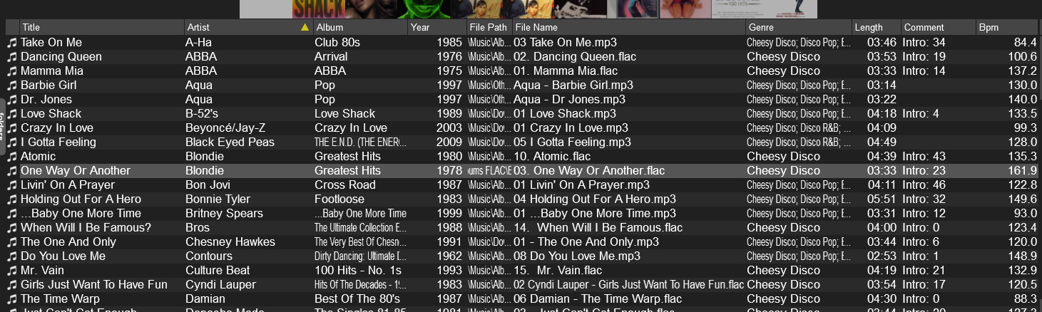

To save having to create playlists etc when I use a new system / reinstall software etc I use the Genre Tag, and have multiple tags for each genre as you'll see in the screen grabs.
This works fine with MP3 files on Virtual DJ, a song which has multiple genres separated with a ; appears in each genre.
However, for some reason with FLAC files - which must of my music is now ripped as, it only shows the first Genre.
For Example:

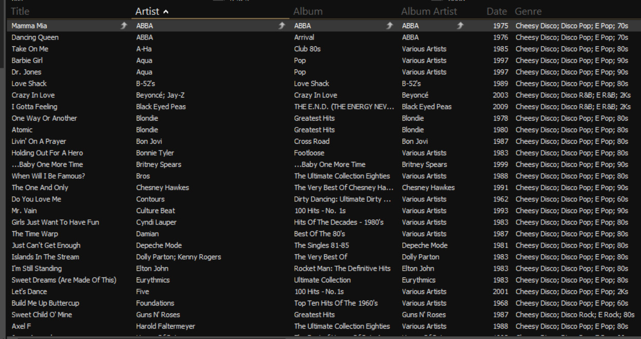

Here is a screen grab from Media Monkey showing a list of files where the first tag is "Cheesy Disco" these files subsequently have other genres such as "Disco Pop" "Disco R&B" whatever.
However the same search in Virtual DJ just shows the first tag for FLAC files, but as I mentioned before, all of the tags for MP3s.
As a result, Dancing Queen by ABBA would appear if I filter by Genre against Cheesy Disco, but not for Disco Pop, but Love Shack by the B-52s would appear under both.
Any ideas how I can make all Genre tags appear for FLAC files?

I notice VDJ is using slash '/' as a genre separator. those in your pics are semi column ';' separed
Posted Mon 04 Mar 19 @ 2:38 pm
Thanks Nicotux, the / does work.
I guess I'm going to have to spend a few days changing things.
Weird that ; works for MP3s but not FLACs!
Does anyone from technical support have a view as to why this does not work?
Thanks
Andy
Posted Mon 04 Mar 19 @ 8:33 pm

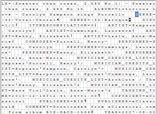

I checked the binary of one of my flac files and think this is somewhat accurate but with a little bit of guessing too.
Maybe it is that the encoder for flac used this method which is recommended:
GENRE=genre1
GENRE=genre2
When displayed in MediaMonkey it may be displaying as: genre1; genre2 because it joined the multiple fields on the fly for display purposes using a semi-colon as a delimiter.
So the software that wrote the tag, maybe using semi-colon as a control, probably separated into above format. Semi-colon not actually written.
When displayed in VDJ, it appears it only reads the first genre field and quits without joining the remaining genre fields.
If the software that wrote the tag using a '/' maybe it did not separate the fields like it was supposed to.
If a / is used, maybe not a real separator, and then vdj reads the entire first genre field as one genre and not separate genres. You can search on multiple genres because the search is just looking for words.
When you use vdj to write the tag using semi-colons or whatever, it writes the tag with the semi-colons and then it works because VDJ did not separate the fields and probably not valid anymore.
I have some flac files with multiple genre fields in the recommended format above and VDJ only reads first one
So it appears semi-colon and \\ are controls on how to write the tag for the encoder. They are not part of genre field. Multiple genre fields are encoded using other special characters and not semi-color but with multiple genre tags. Here's a subset of the hex display of a flac file... You can see 2 genre fields, first starting at blue rectangle. This appears to be the proper format for tags in flac files. If you write the fields as one long string like: genre1 / genre2... then programs will most likely read it as one genre field with slashes and not actual separate genres which could break software that depends on proper encoding.
GENRE=genre1
GENRE=genre2
Posted Tue 05 Mar 19 @ 6:16 pm
