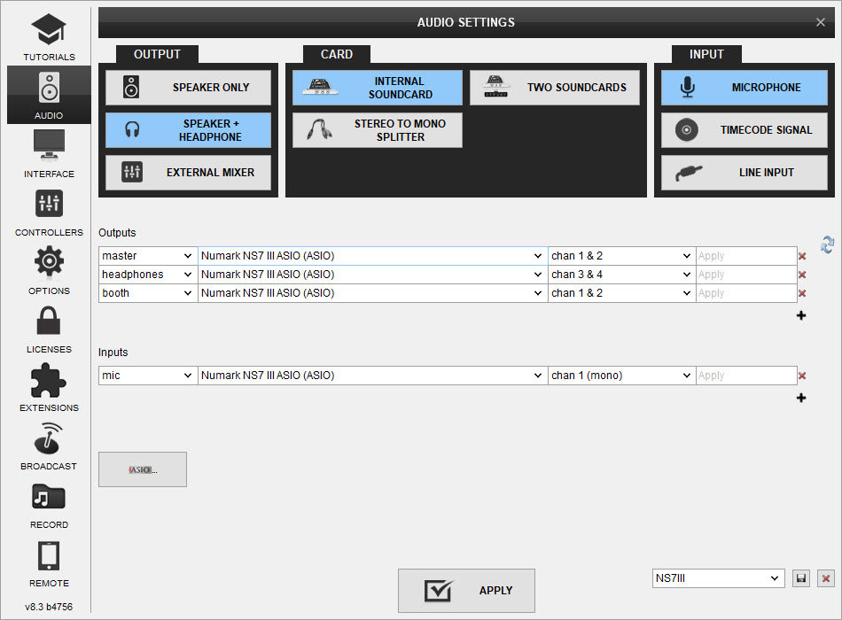

On my NS7III I have seen the same "Strange Behavior #2". For me it has always been something I did. One time it was that I thought everything was plugged in and ready, but I actually had not plugged my laptop power supply all the way in on the AC line cord side. The power brick was plugged into the laptop so this one took me a bit to find and scared the crap out of me. After plugging the laptop in I typically restart to clear any battery power save options. I find my external monitor and wall power always need to be ready BEFORE starting the laptop. It shouldn't make a difference but it does.
Maybe check your power save, USB power save, core parking, speed step settings. The only other time I see this issue is when my ASIO buffer is set too low. Adding latency is not fun but it beats what you are dealing with.

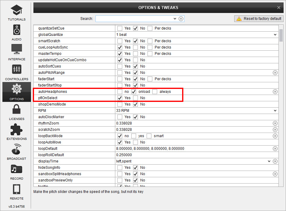

As far as #1 mine always has auto PFL and no issues with sound card config. This could also have something to do with your other problem. I have seen staff recommend removing your VDJ settings file and re setting it up. You don't have to delete it, just move it somewhere safe and try setting VDJ up with the necessary setting to see if that helps.
Posted Sun 24 Feb 19 @ 4:17 pm
Here are my working settings. My machine was pretty top spec a while ago and I format about once a year for a clean windows install. That being said I could never get flawless playback below ASIO buffer of 192 on my Win 10 machine. Win 7 on the same machine I ran with 128 for years. Unless you have an i7 processor, multiple internal SSD drives, 16gb of ram, 6gb NVIDIA card and a very clean install, I would not try to go below that. I have used 256 for a long time on other PCs without much issue.

I did a bunch of things as well as your suggestions too and still wasn't right. I have the same pfl settings as you've shown in your images and still I have to manually press it. I've no gigs this week which means I can properly investigate this with no time limit. Hopefully something simple will show up. I'll let you know what I find.
