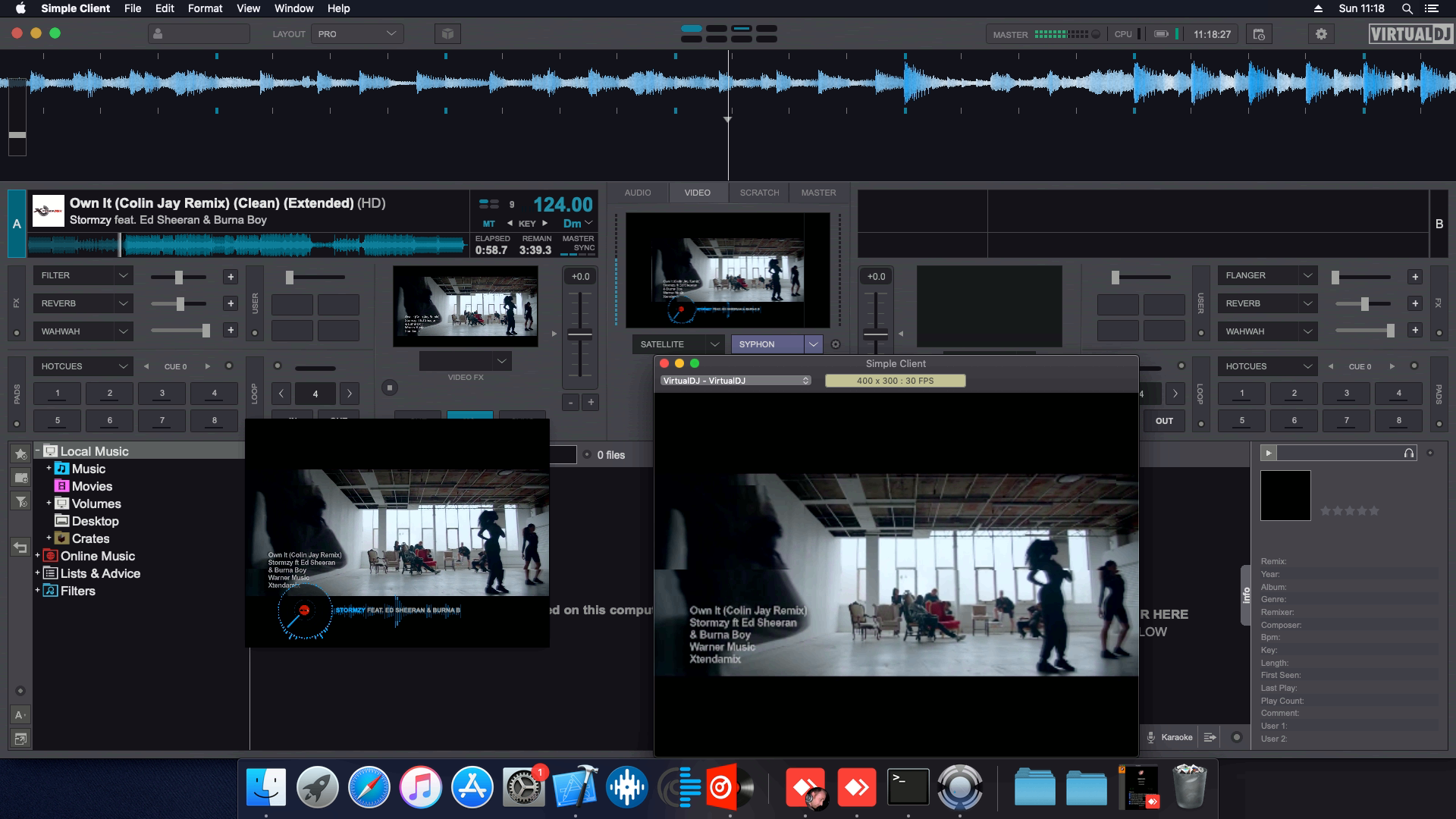

Where can I download the syphon or spout plugin for vdj2020? I've searched the extension area in the app but nothing comes up.
Posted Sun 09 Feb 20 @ 2:42 am
spout plugin is verry experimental and not in the download area
https://github.com/leadedge/SpoutVDJ
browse "releases" tab for binaries
Posted Sun 09 Feb 20 @ 9:28 am

You know how rewire shares real time audio between programs, these are the video equivalent [very basic description]
Posted Tue 18 Feb 20 @ 2:28 pm
Syphon / Spout actually allow applications to share their output as an input to other applications even over network
They are some kind of "virtual video cables"
Syphon is an open source Mac OS X technology that allows applications to share video and still images with one another in realtime.
http://syphon.v002.info/
spout is a Realtime video sharing framework for Windows
https://spout.zeal.co/
Posted Tue 18 Feb 20 @ 2:29 pm
