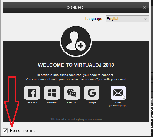

This option can also be found here:
Posted Mon 10 Dec 18 @ 10:54 am
