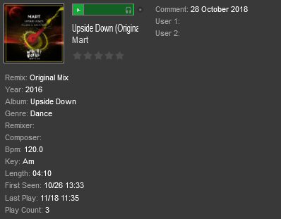

I have another question if it is okay to ask I would like to put some info into that panel that I have now created . From the browser is this possible .
This is the info I want to use
I am slowly getting my head round the new skin engine its just a little bit harder for me as I have dyslexia .
Posted Wed 21 Nov 18 @ 3:10 pm
The info panel itself is hard coded and not skinable. The only options you can add are those available in the drop down menu.
In theory you could create a new info panel using split panels in the browser but I am yet to fully understand how that works.
Posted Wed 21 Nov 18 @ 3:19 pm
